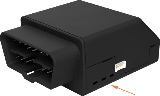

LED Guide
Ignition state
LED pattern Description
Red Off Ignition is off or vehicle has not been detected
Red Solid Ignition is on
Communication
Orange Off Modem is off
Orange Solid Connected to Alarm.com
Orange Flashing Searching for cellular network
Orange Rapid Flash Connected to the cellular network but not to Alarm.com
GPS
Green Off GPS is off
Green solid GPS is on and the current location has been determined
Green flashing GPS is on, searching for a location
Green rapid flash Requesting time from the GPS satellites
