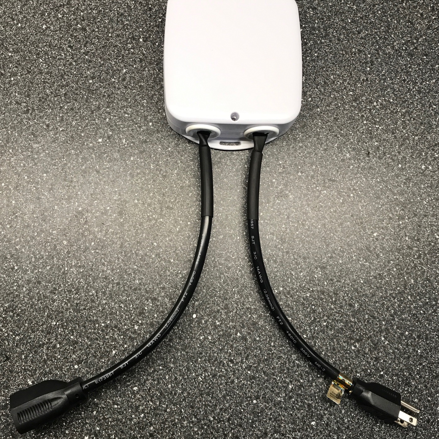

Extremely helpful! So, it looks like I am going to be working with the 120 single phase. I am thinking I will simply take a 3 prong extension cord, cut it in half, wire each side to the heavy duty switch. Then I can plug my sump pump in to the female, and the male into the wall outlet. Is that feasible?
That is something I would consider so that the device needn’t be spliced into the Sump power cable, however you may want to make sure the extension cable is not a smaller gauge like 18 (as is possible with shorter extension cables I think) I would strongly suggest consulting a licensed electrician regarding the installation of any high voltage devices.
Sounds good. I purchased a 14 AWG extension cord. Table 310.16 in the NEC code book states 14 AWG should be good for up to 20A, though a lot of people say to use for only up to 15A.
Talking to my electrician, he believes max draw on the sump pump is 13A, so I should be covered either way. This will allow me to easily remove/move/exchange the smart switch if/when necessary and make an easy install.
Once I get it wired up and tests good I’ll post up a pic and results here. Thanks!

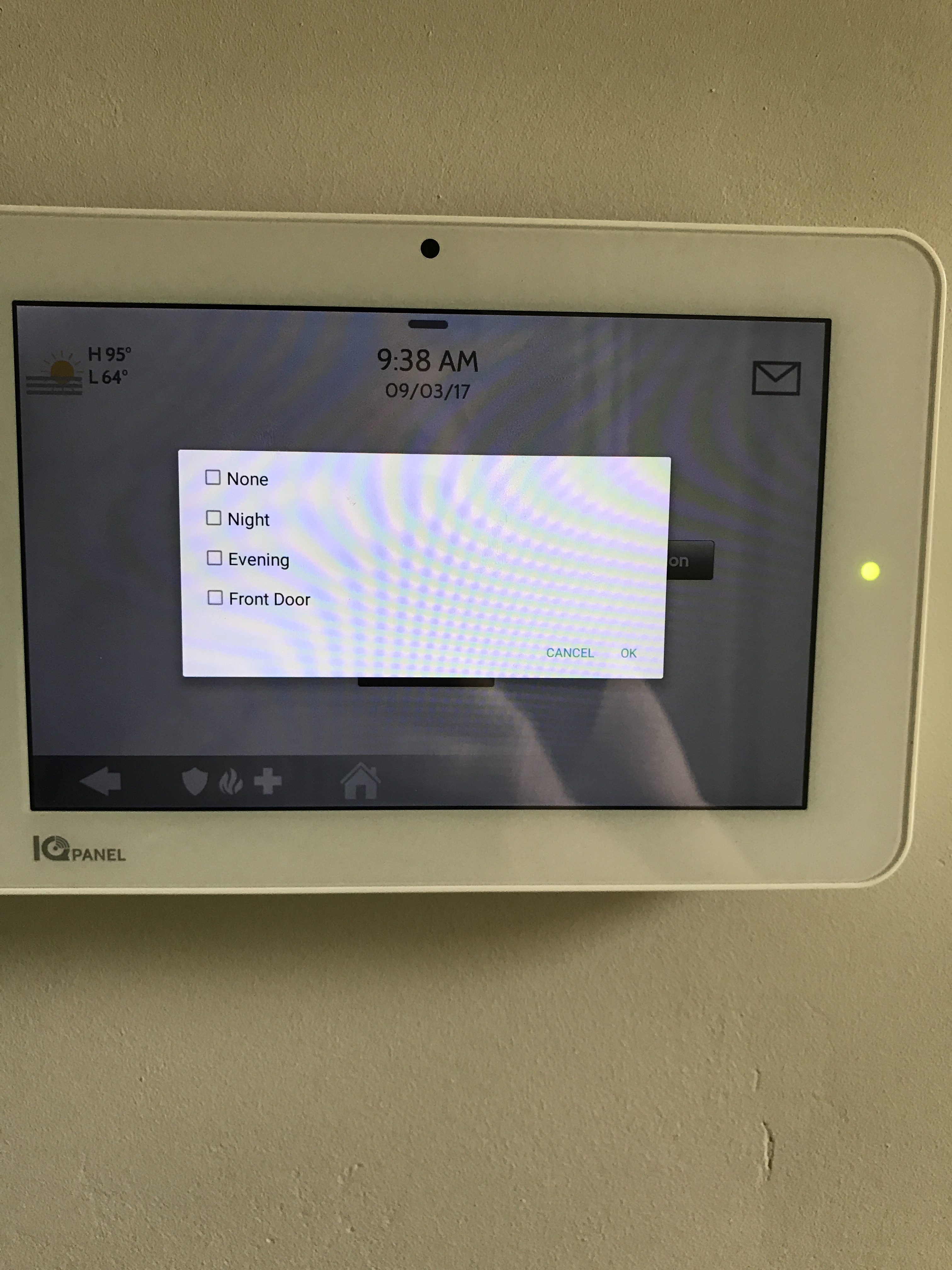

I got it wired up, added it as a z-wave device on a Qolsys IQ2 Panel. However, the only option I see is a light switch. Does the IQ2 panel not support it, or am I doing something wrong? Thanks.
I see it showing up in ADC as an Energy Meter under the Energy tab. I do not see a sump card under water.
Hmm, I do not see options on our end to add a sump pump and configure which sensor it is attached to, which should be visible with a Heavy Duty Switch.
There may in fact be a difference due to the IQ Panel 2. We are following up with Alarm.com and determining whether this is a panel limitation currently. We will update this thread once they get back with confirmation.

While compatible with the Qolsys panel itself, there may still be an issue with syncing with ADC.
Typically we will be able to see the option to “Add a Sump Pump” and assist with configuration, but this is not present on your account despite the heavy duty switch being installed. The issue would likely need to be resolved or directed by ADC.
Just to make sure we have all the info, could you provide the exact model number and revision of the Heavy Duty Switch? If possible the manufacture date if on the label.
