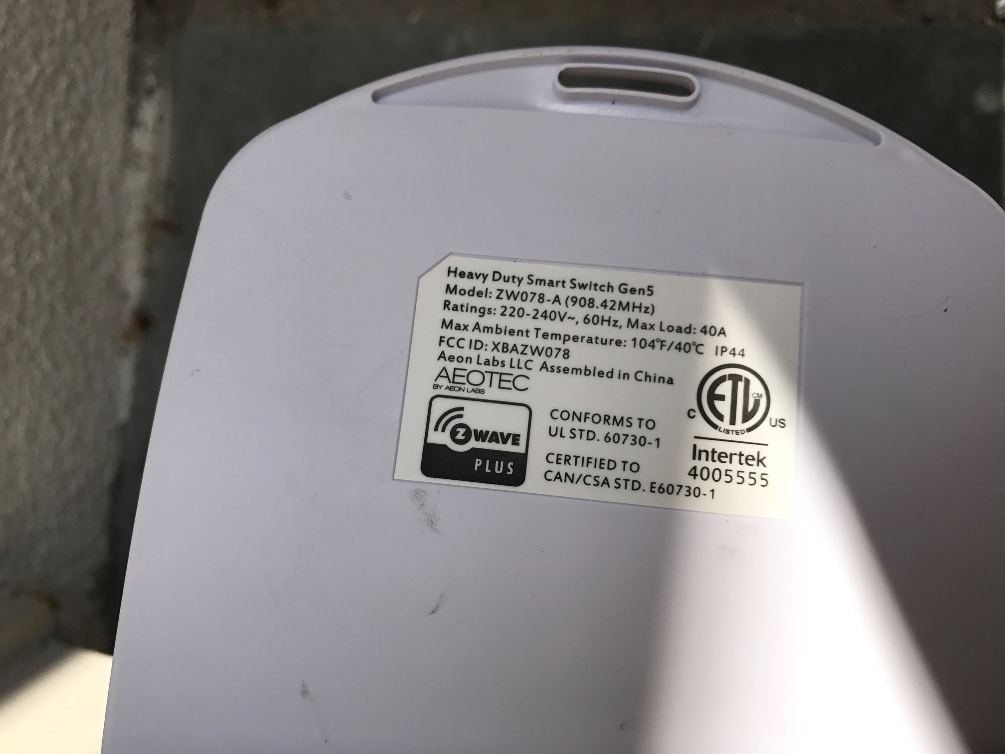

Just to make sure we have all the info, could you provide the exact model number and revision of the Heavy Duty Switch? If possible the manufacture date if on the label.
The link to what I purchased: http://a.co/i7150s9
Aeon Labs ZW078-A,White,V3.26,US,AL001 Zw078-A Z-Wave Heavy Duty Smart Energy Appliance Switch, Small, White
Attached a pic of the back label… Didn’t see a manufacturer date anywhere.
