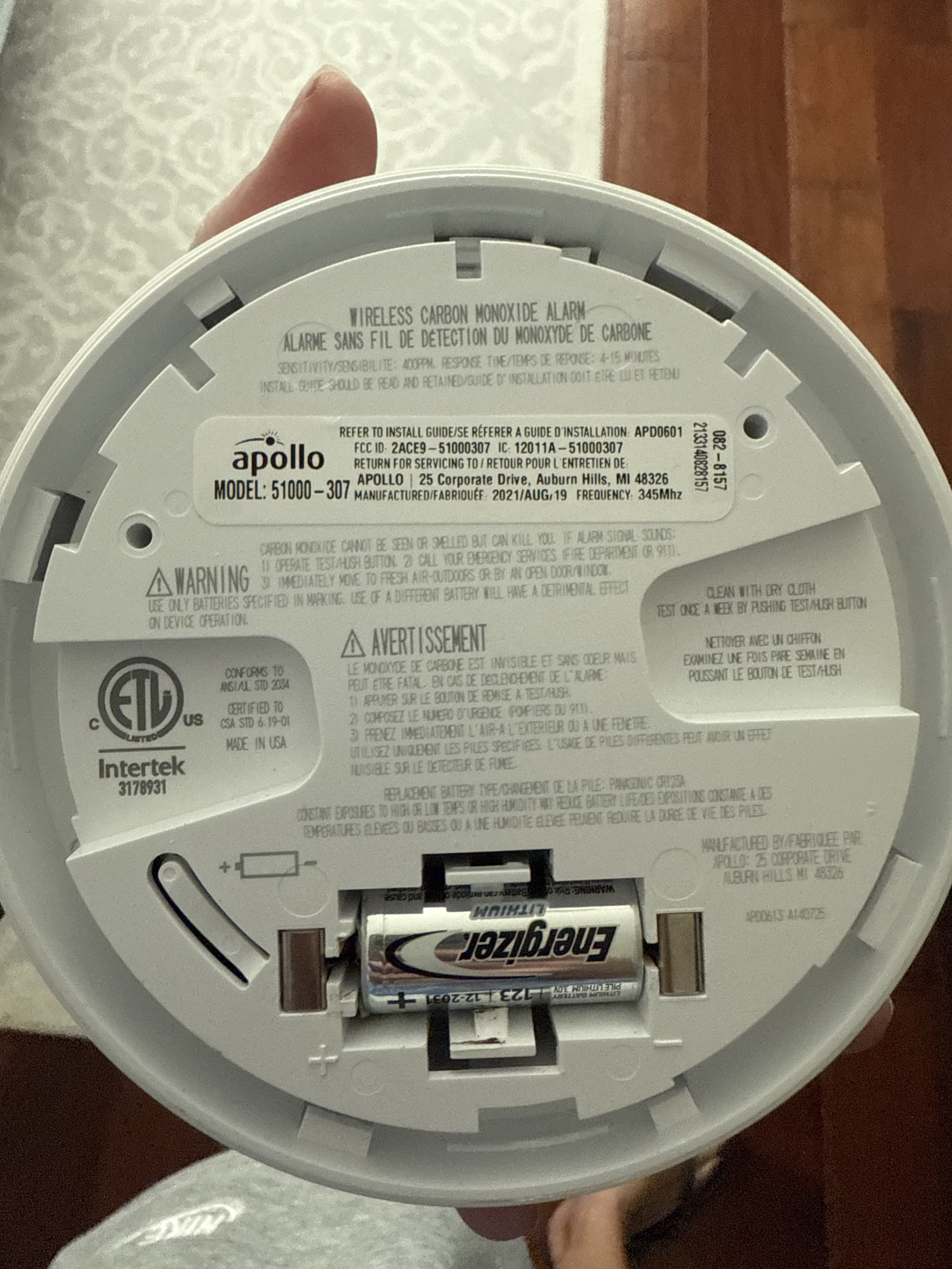

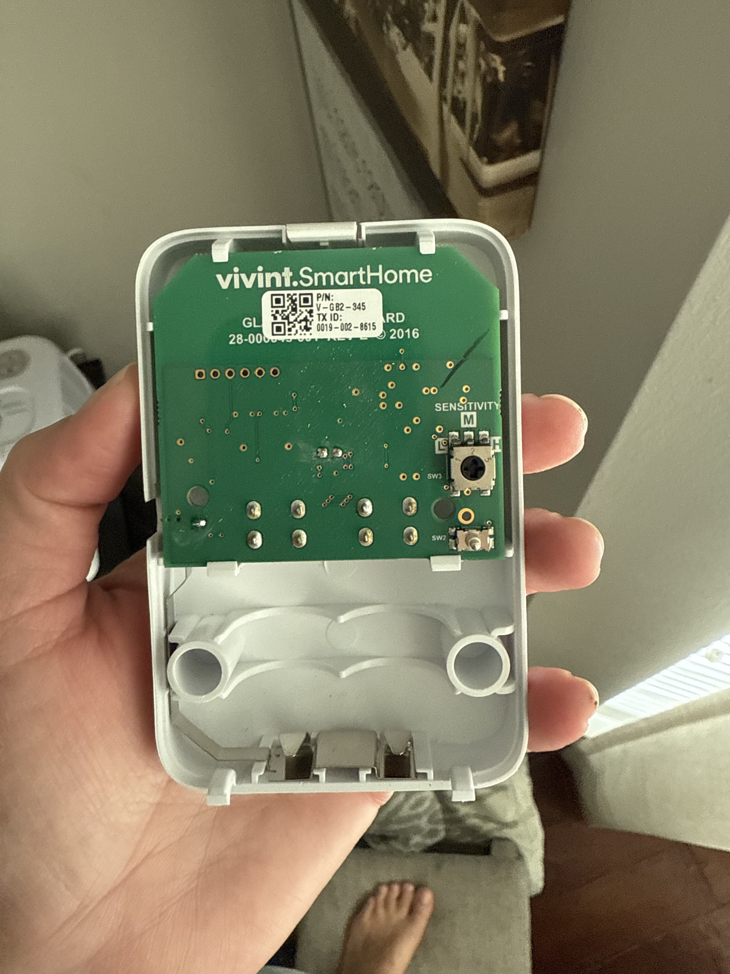

Is that on the back on the sensors?
Yeah it would be on the label which is found usually on the back of the sensors.
The Apollo detector I am not familiar with. It might work, I am not finding reference to it being encrypted or Vivint only.
However, the V-GB2 is a Vivint only part number for a glass break. To my knowledge it will not work The standard 345Mhz 2GIG Glass Break is the 2GIG-GB1-345.
That glass break suggests you likely have all proprietary security sensors which won’t be able to be reused on an IQ Panel 345Mhz version unfortunately.
