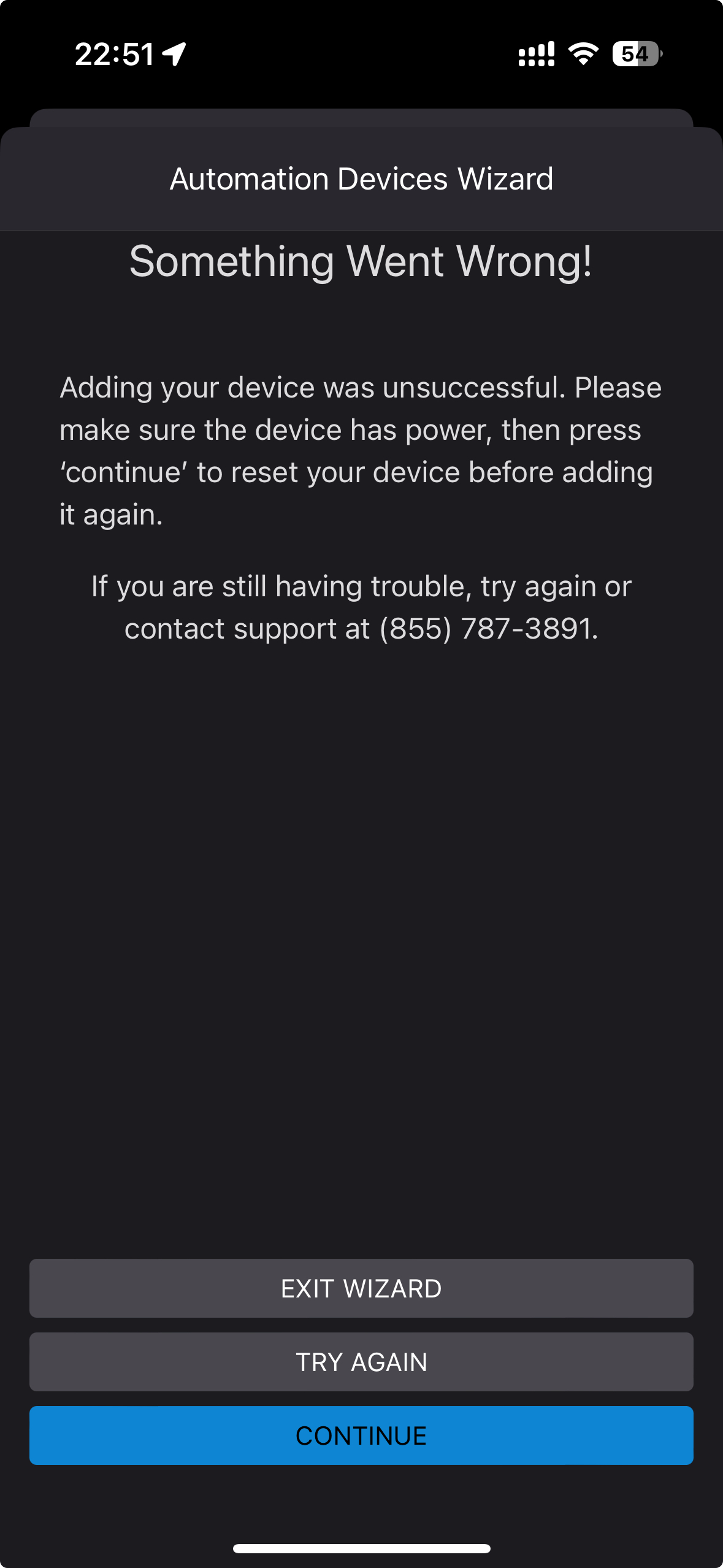

I’ve been successfully using the add new zwave device from the iPhone app for weeks and just the other day started getting this:
Any suggestions or ideas?

I understand all these possible troubleshooting steps and workarounds but the wizard was working fine (on all floors and locations of my house). All of a sudden it started throwing this error for no known reason. I removed the last switch I added in case it was causing an issue but no luck. It says to call this #:
(855) 787-3891. I’ll maybe try that next week. Pretty frustrating when it was all working well then all of a sudden stopped. I also added a new Yale lock around the time it started misbehaving but think I was still able to include it from my mobile. Maybe I’ll remove that device and see if it helps.

Thanks. It still didn’t make sense why it was working fine before from my mobile app then all of a sudden stopped. The device I’m trying to add is the 2nd closest device to my iq4 panel (~15ft) with direct line of site.
