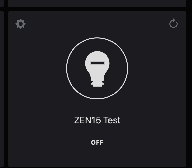

if this is still an error or bug, it would work in my favor! Perhaps Zooz wants it coming up as water valve as its for appliances? any way to follow up?
fyi, it was fixed. ZEN15 comes up as a switch now…
