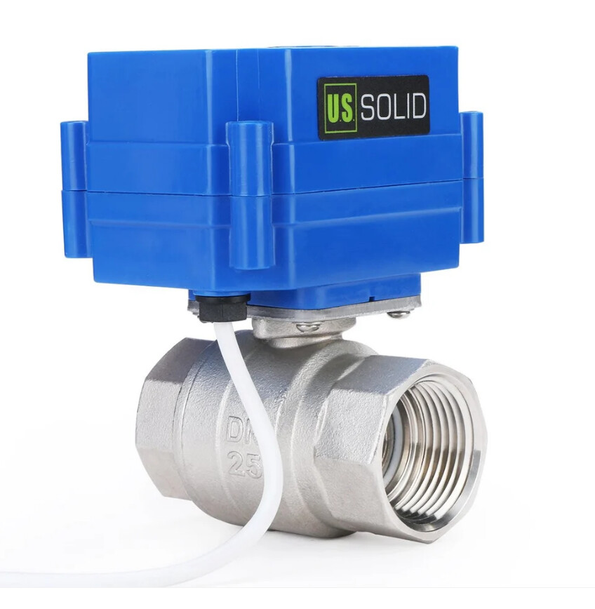

I am considering building a lower-cost Z-Wave water shutoff rather than buying one of the more expensive dedicated Alarm.com-compatible valves.
The proposed setup uses:
  • U.S. Solid 1-inch stainless-steel motorized ball valve
    • 85–265V AC
    • Two-wire auto-return design
    • Power applied: valve opens
    • Power removed: valve closes
    • Automatically closes during a power outage
    • Approximate cost: $65–$80
  • Zooz ZEN05 outdoor Z-Wave smart plug
    • Weather-resistant for use near plumbing
    • Controlled through a Qolsys IQ4 panel
    • Approximate cost: $29
  • Polarized replacement power cord
    • Male plug on one end and bare conductors on the other
    • Approximate cost: $8–$12
  • Weather-resistant junction box, strain reliefs and connectors
    • Used to enclose the splice between the valve wires and power cord
    • Approximate cost: $15–$25
  • Plumbing fittings
    • Depends on the existing pipe material and installation
    • Approximate cost: $20–$40
Estimated total cost
Approximately $140–$185, not including professional plumbing or electrical labor.
How it would operate
The valve plugs into the Zooz ZEN05.
  • Zooz ON: power is supplied and the valve opens
  • Zooz OFF: power is removed and the valve closes
  • Utility power failure: the valve automatically closes
  • Power restored: the Zooz should restore its previous relay state, allowing the valve to reopen if it was previously ON
The ZEN05 would be enrolled into the IQ4 as a Z-Wave switch or appliance module. The valve itself would not communicate with Alarm.com. Alarm.com would control the Zooz plug, which controls power to the valve.

Looks good. I just think the one I posted seems more robust and it’s not turning a handle. It’s an actual ball valve that’s staineless and it’s less money.

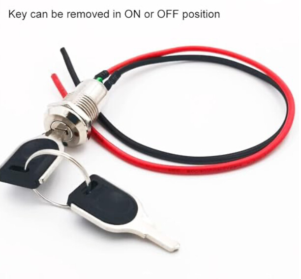

Also, since this (for my use case) is for lawn irrigation, I need that valve to stay closed in the winter. My plan was to install a key-based switch so it can be “locked out” in the winter and not accidentally be opened, since the system will be winterized. This would break the connection after the ZEN58 for safety’s sake.

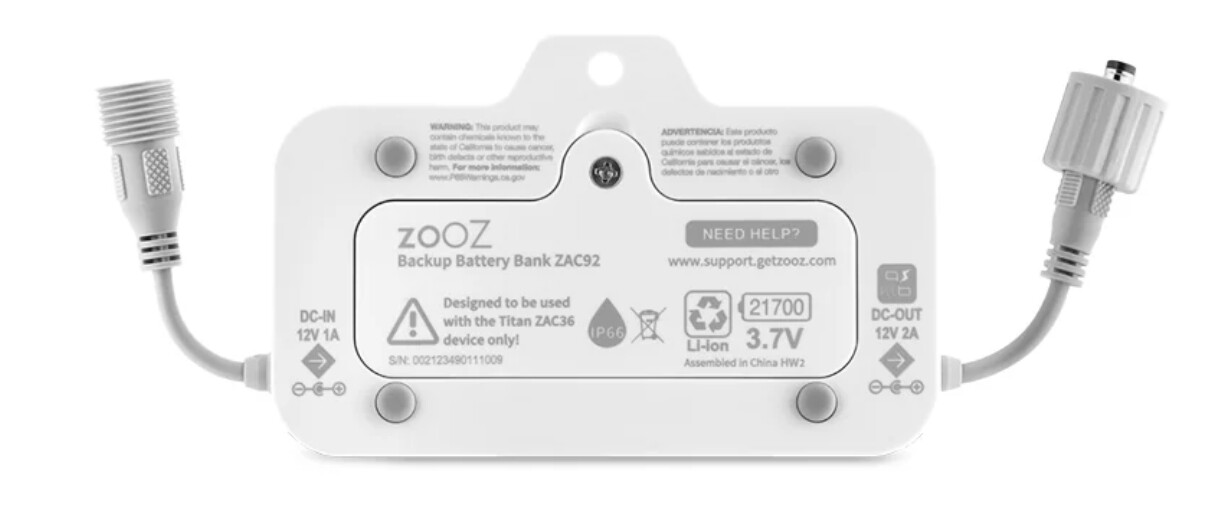

fyi The Zooz valve actuator ($49) has a battery backup option, and the titan water valve itself has a wired water sensor directly connected to work without the hub if necessary.
For my use case, though, it is the wrong product, since the titan by default will cycle itself off/on periodically to exercise the valve. Nothing I want to risk in a winterizing situation. And I agree that if your existing ball valve is not cooperative this actuator may have difficulty. I have that same issue as my existing irrigation valve is a mess and very very hard to open/close.

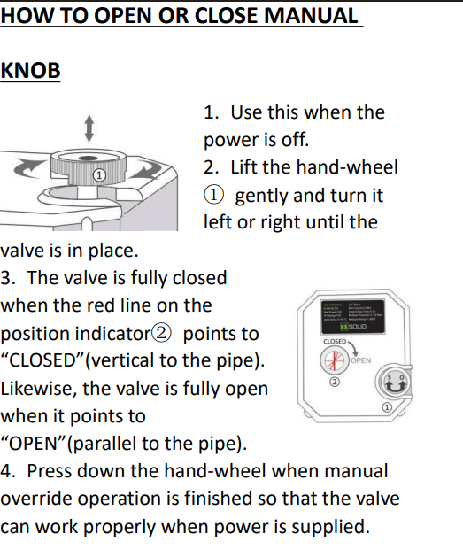

Just discovered that they make a model that has manual open and closed. So if power is lost the valve shuts, but at the top is a manual screw so you can open it without power
So in summary, this device is open when power is on and water flows. If you turn off the zwave plug through ADC, water stops as the valve closes.
If there is a power outage the valve closes. If you are home and need water, you would go to the valve and manually open the valve and you would have water.

I installed the Zooz Titan Water Valve Actuator along with the optional battery backup. Initially, Alarm.com was reporting a low battery warning even though I didn’t have the battery installed. The actuator was already running the latest firmware, so rather than spend more time troubleshooting, I decided to purchase the battery backup. Once installed, everything worked perfectly.

With US Solid as I have described, it can integrate with Zwave and IQ4 and be automated to shut off with IQ water sensors. Its seems like a more robust piece at a fraction of the cost. Again, I’ll test and report back. I’m also encouraging the manufacturer to work with ADC if there is enough interest

This has been installed an I have tested over a few days. This works great. Its a really solid unit and I don’t have to worry about another fail point (e.g. a handle not turning).
Connected to a zwave switch and it simply plugs in. To close valve i turn switch off. If there is a power outage the valve closes, but there is a manual over ride option where you can just pup up a turn screw and manually open the valve.
