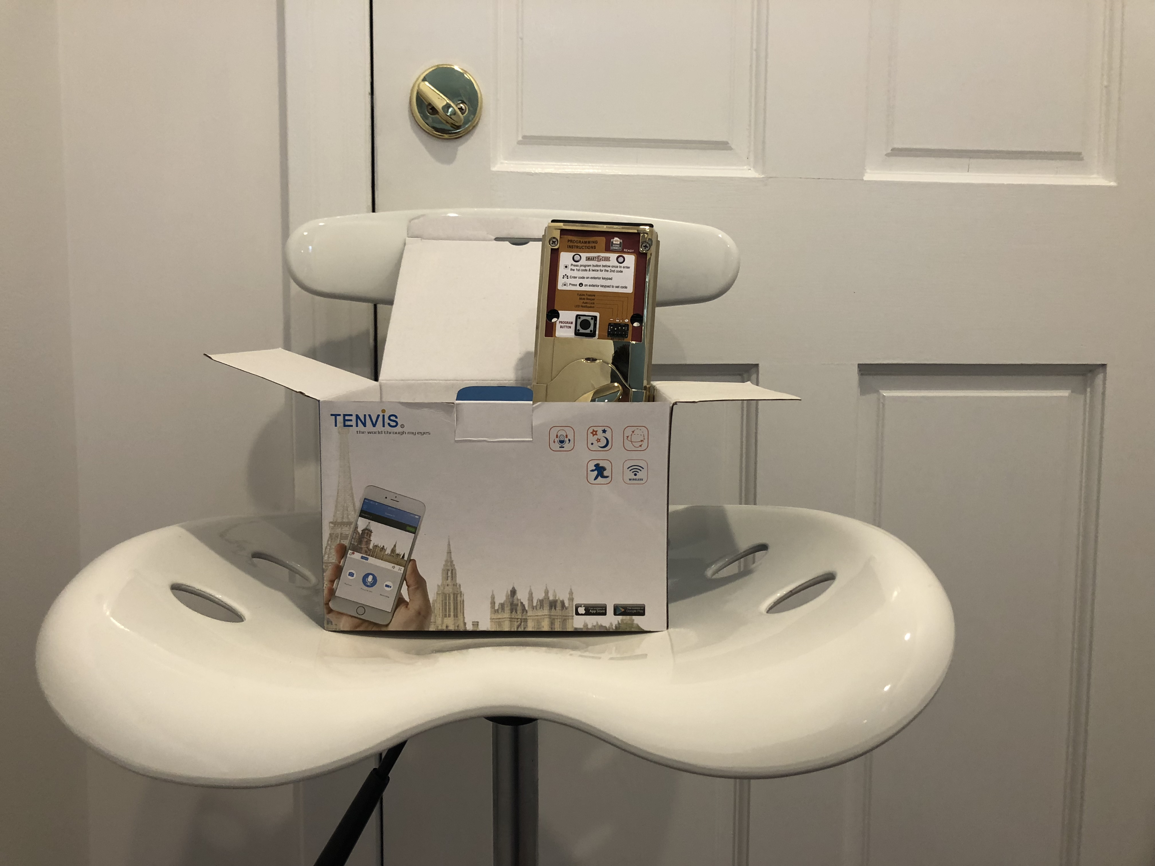

The dimmers are located in a 20 x 40 mostly open concept room.
The first dinner is located 15 feet from the panel the second dinner is located 15 feet from the first dimmer the third dimmer is located 15 feet from the second dimmer laid out in a triangular pattern within the room as pictured. The lock is located within 6 feet of the third number. No obstructions.
I sent a couple commands including another rediscovery and now the lock is showing having one of the dimmers as a neighbor node (looks like the 3rd, which would make sense).
It still reports lower signal strength. Can you go ahead and see if you get success sending from the panel or adc?
No luck. Lock screen minutes after I sent a signal from the app, then I sent another signal to unlock from the app and it wouldn’t work at all.
I tried sending commands from the panel but it just stays in “ acquiring Z wave signal” then it Times out and tells me maybe my batteries are bad but that’s not true.
These devices suck. 10 hours is my limit to try to program three stupid dimmers and a lock. Lol l Can you suggest a device that would work through Wi-fi?
