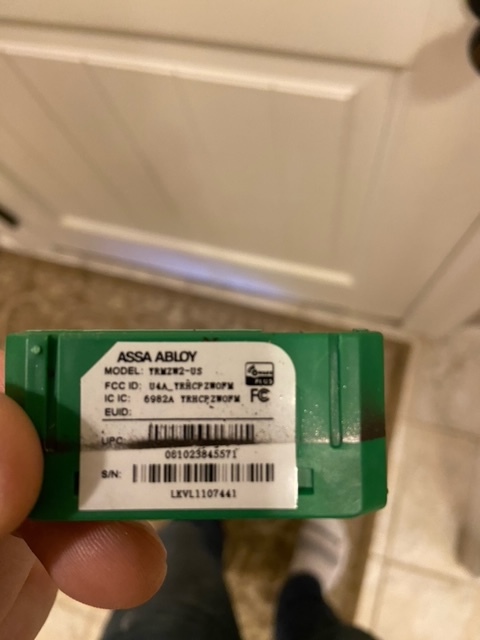

I’m starting to think there is just an incompatibility going on. What is the exact model of that lock? Can you provide a photo of the label on the Z-wave module that is installed in that lock? The Yale ones are removable and above the battery compartment.

Locks using are Yale YRD216 with the newer green zwave chips see attached pic of the one currently in that lock
I have other locks & chips if need to troubleshoot something specific
Do those other locks run into the same issue if added? And if not, do they have any different versions on their labels?
