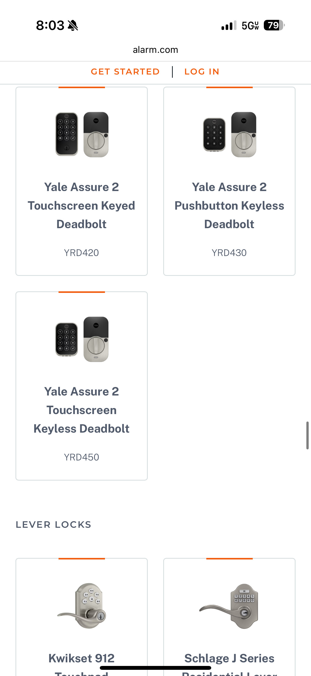

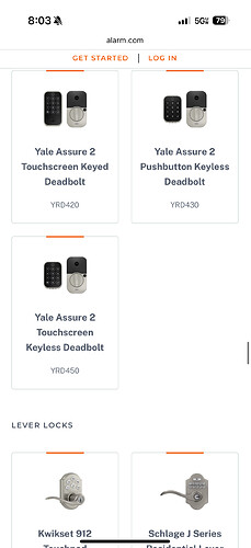

I have attached the picture that shows the compatibility from the alarm.com website.
So you’re telling me that there is a model YRD450 that is z wave not WiFi?
Yes, there are Z-wave, Wifi, and Bluetooth models for the lock models.
