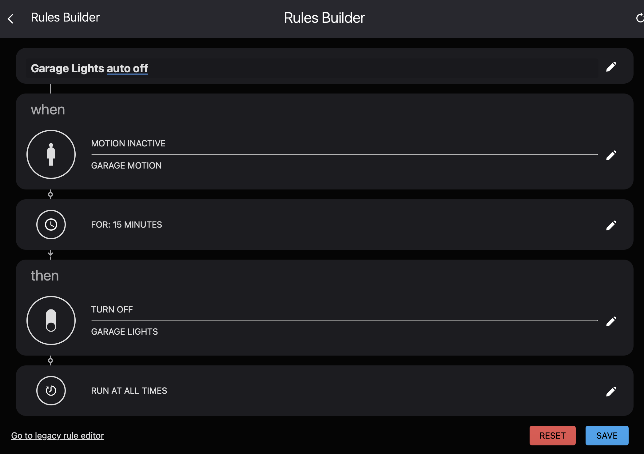

I believe this is possible for the scenario you described. But it seems to allow you to control lights (not actual scenes as far as I can see.)
I have similar setup, using the PG9914 in my garage. I assume hard wired motion would be similar.

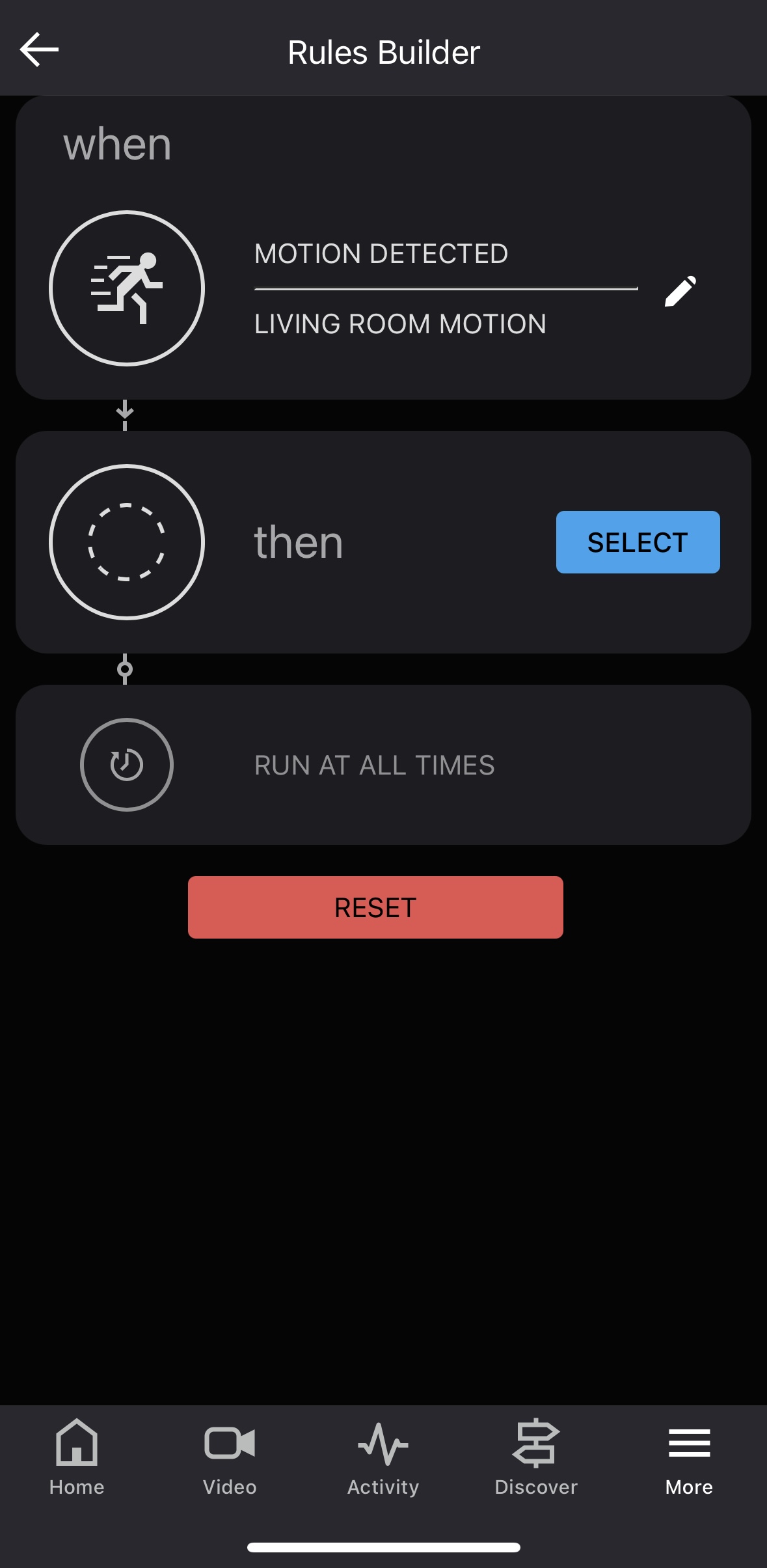

The sensor activity could be used to trigger rules, but sensor activity cannot trigger Alarm.com scenes currently. You can instead create rules to control lights, shades, thermostat based on sensor activity.
The logic would be reversed for your example of no motion. There aren’t occupancy rules like that looking for a lack of activity, but you could have it set up so that during a certain time frame whenever the motion detector is tripped the light comes on, then it turns off at a selected amount of time later.
The light would be triggered by the activity at the motion detector and turn off on a timer after the activity stops.
