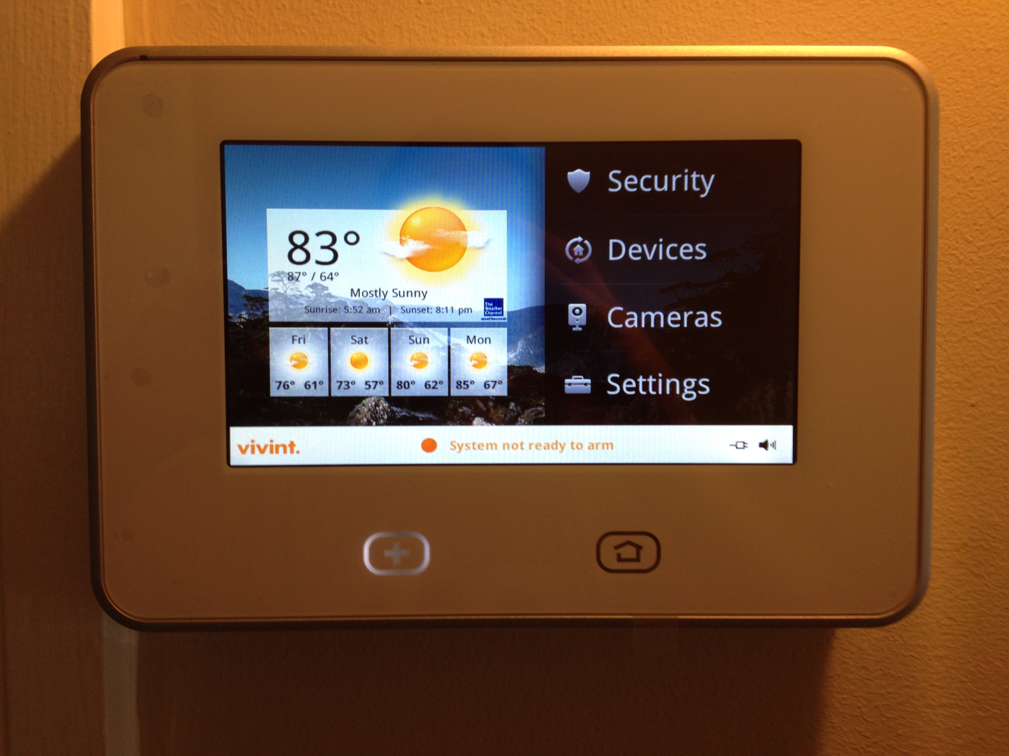

I recently had a Vivint system installed, with the new panel, but canceled within my 3 day trial period. They have abandoned the equipment and I’d like to use it with a different provider. Do I just need to switch out the cellular module to do so?
Interesting question. Their newest panel was purchased from 2GIG for their sole use. Since its brand new, and I’ve not before heard of a 2.0 panel being left behind, I’ve not encountered this question before. Are you positive that you are not under contract? I’ll do some follow up investigation, but I doubt there are alternate cellular modules available for this particular panel to use with other providers. To use the sensors you have, you may have to replace the panel with either the first Go!Control panel or the soon (we hope) to be released Go!Control 3.0. We’ll follow up to be sure, but I’d be very surprised if the panel could be used by alternate providers powered by Alarm.com.

I’d like to keep the Vivint panel if I can because it is really pretty nice. Thanks for checking into whether I can put a new module in it, I’m interested to see what you learn.
Would it be possible for you to post a photo of what the module looks like? According to a colleague here who has discussed the panels with 2GIG, the 2.0 uses the same modules as the previous model. But not having hands on experience with the 2.0 version, visual confirmation would be nice. Still investigating for a more definitive answer.
You would definitely be able to use the existing sensors, as the same ones are used for both panels. Word from 2GIG is that the modules for the CP-21 Go!Control 1.0 should work with a firmware update on your 2GIG Go 2.0 panel. The firmware can be shared across the two panels is what I am being told. I want to verify this with engineers, but it could possibly just require a new module.
Would it be possible for you to post a picture of the communication module itself or maybe just the inside of the panel itself?
No need. I’ve received clarity on this from our partners at Alarm.com. I’ve been told that the 2.0 uses a completely different back end. It’s a new alternative to Alarm.com. We’ve been told by ADC that these panels can NOT be used with Alarm.com, regardless of the provider (Vivint or otherwise). The back end it uses is specific to Vivint. (Still wish we could get our hands on one to test in our office.) In order to use Alarm.com services (and/or use the sensors with any provider than Vivint) you would need to replace the panel. The original Go!Control panel has a different look, but there is a newer version (the 3.0) we’ve been (impatiently) waiting to see released which will look more like the 2.0 / Qolsys panel.

David, open up your panel and take pics of the board/modules inside.
Let’s see the cellular module. Also try hittimg the Vivint logo on screen (or settings button) and if it asks for an installer code enter 2203… Take pics of screenshots
Let’s see
I am certain after discussing with ADC engineers that the 2GIG tech response was misleading. They likely mistook the questions I asked to include the compatibility of products between the CNTRL1-345 and CP21-345 model number for the Go!Control panel. They are the same panel, so that shouldn’t have been mistaken, but I will bet it is the case.
@jason
The fact it uses ADC IP cameras, means that the 2GIG Go2.0 aka sky panel is using using alarm.com back end to an extent (I suspect for home automation aspects)
The panel itself also uses a cellular module and wifi, I want to see what the module is, and if the installer code is the same
If the installer code is the same, the panel can be taken over.
I need to just see the module, and the system config screen
