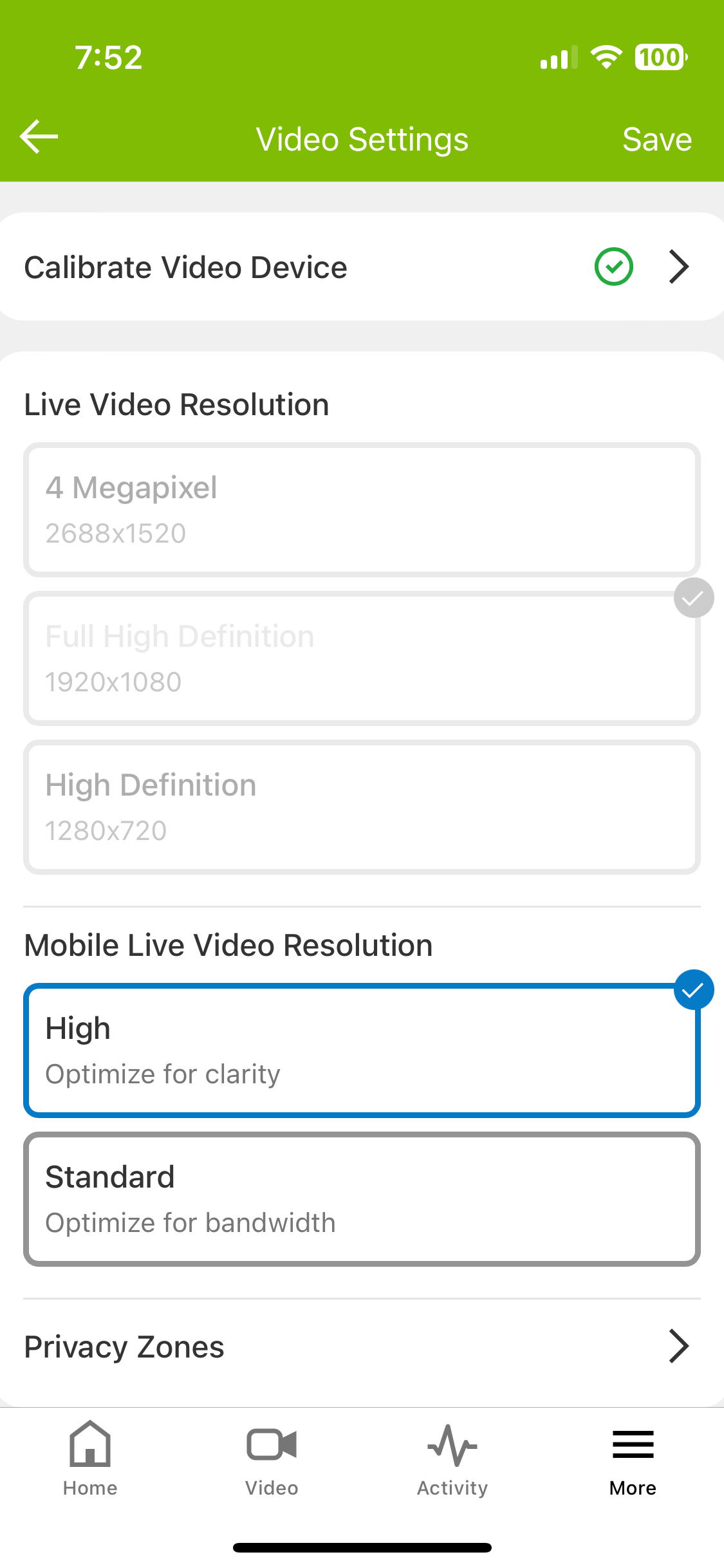

I am experimenting with both of the above cameras in my system, and I notice that the VC838PF lets me adjust the live video resolution, while the VC728PF does not. But from my reading of the specs sheet they are the same, and they both should. What am I doing wrong?
To clarify, SD Recording = Onboard Recording. I’m showing a schedule, Onboard Schedule: Front camera for that camera. This can be found under Video > Recording Rules > Local Recordings.
And further, I think we are discovering that whenever we use any recording of any type, we cannot view live 4MP video.
Looks like 4MP is available when streaming via SVR local display using ADC-CSVR126, Pro Series ADC-CSVR20XX SVR.
