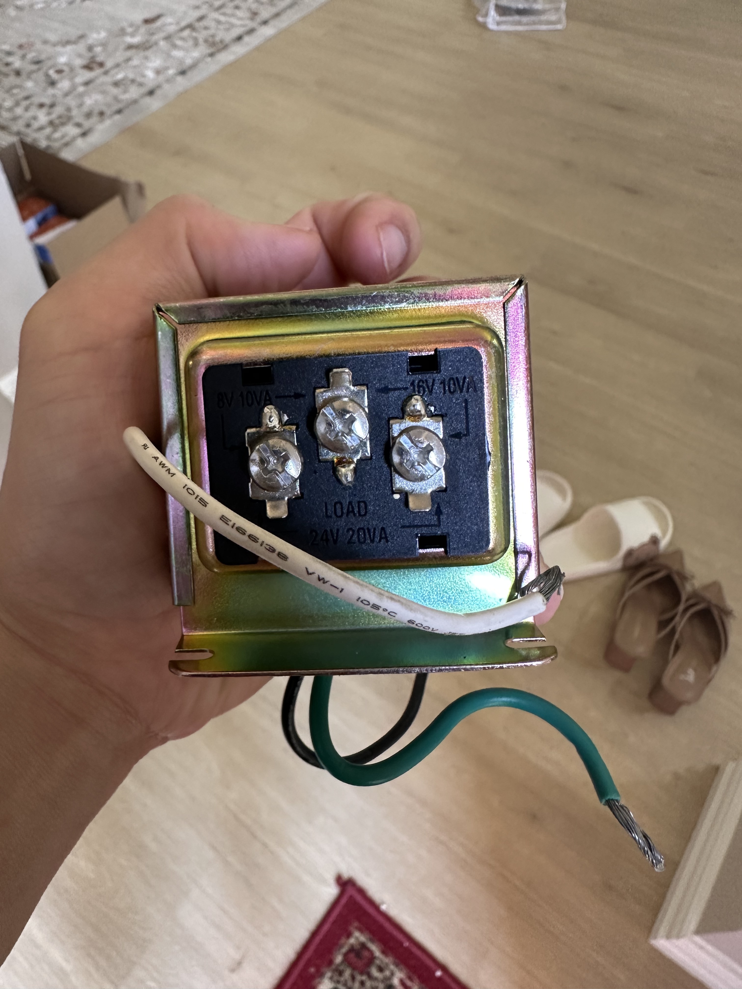

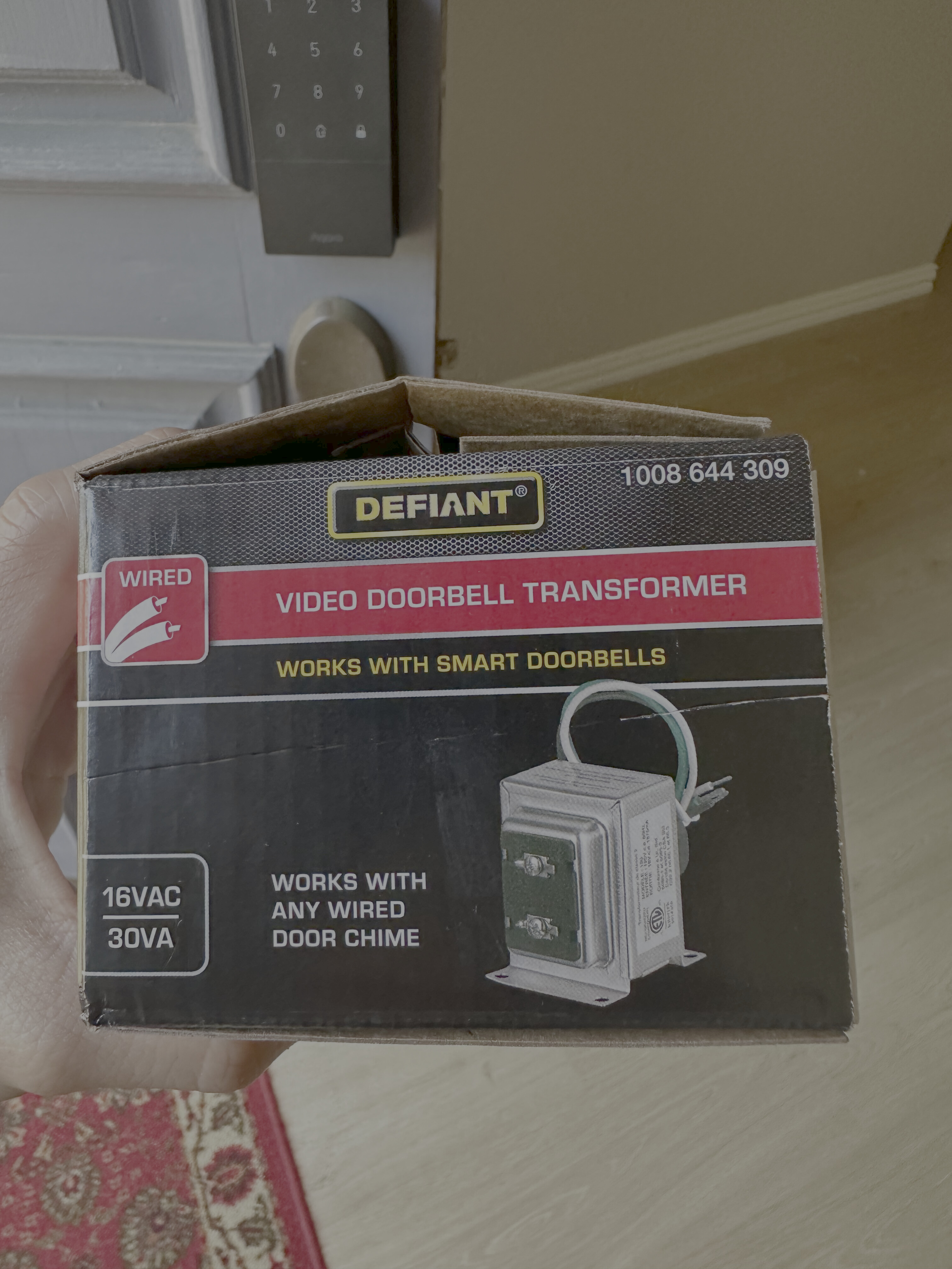

The Mechanical Chime Dongle was confirmed to be connected. The existing transformer was 16 VAC and 10VA (pictured below). Since the bell was still not going all the way, we swapped it to 16 VAC and 30VA. Still not ringing fully. Should we try 40VA? Or is there a digital chime we could use?

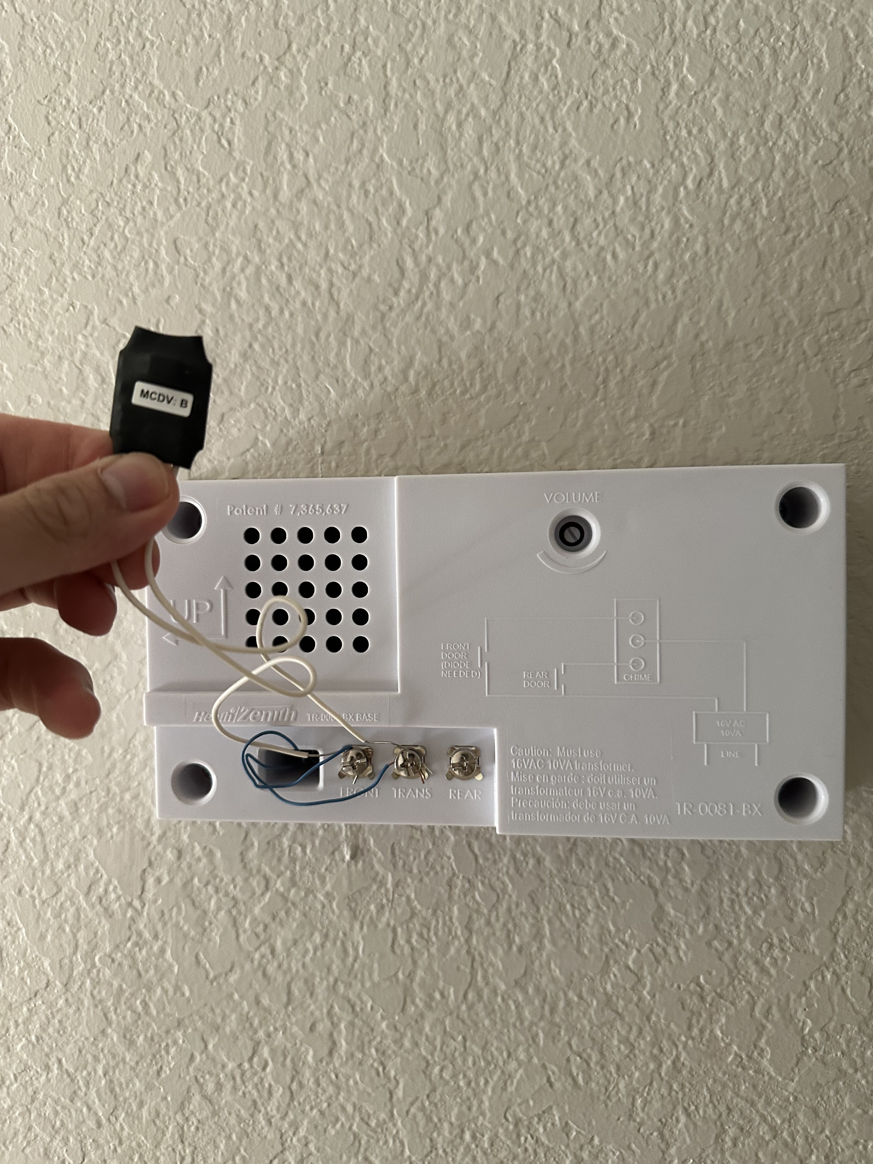

Can you provide a picture of the wiring of the mechanical chime dongle at the chime?
Here you go. Let me know your thoughts.
You actually have a digital chime and not a mechanical chime. If using a digital chime, you will need the Doorbell Camera Power Module VDB775
