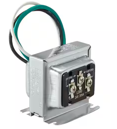

Can you tell if I need a new transformer from this? It looks like 770 and 775 transformer specs are similar.

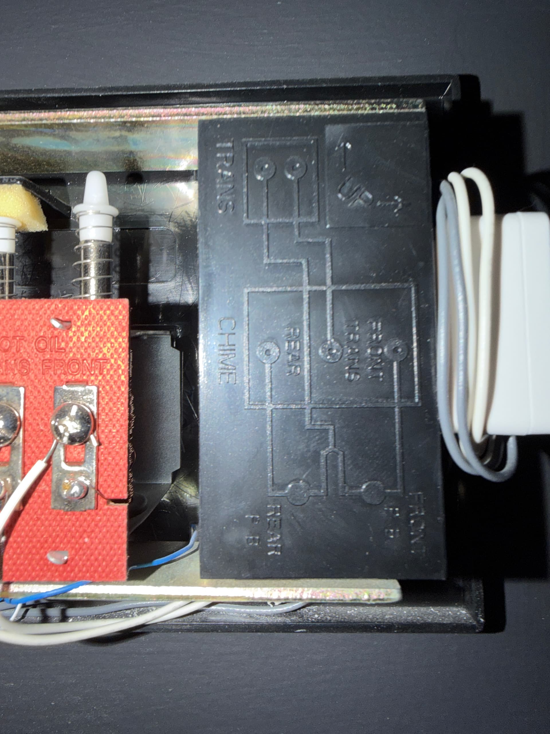

Hello

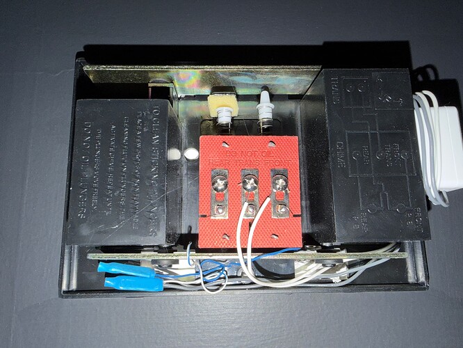

The item in the picture is the chime. The transformer for a doorbell usually looks like the picture below. It is usually located near the chime, garage, entry closet, or attic. The transformer is where we will be able to tell if it provides enough power for the doorbell

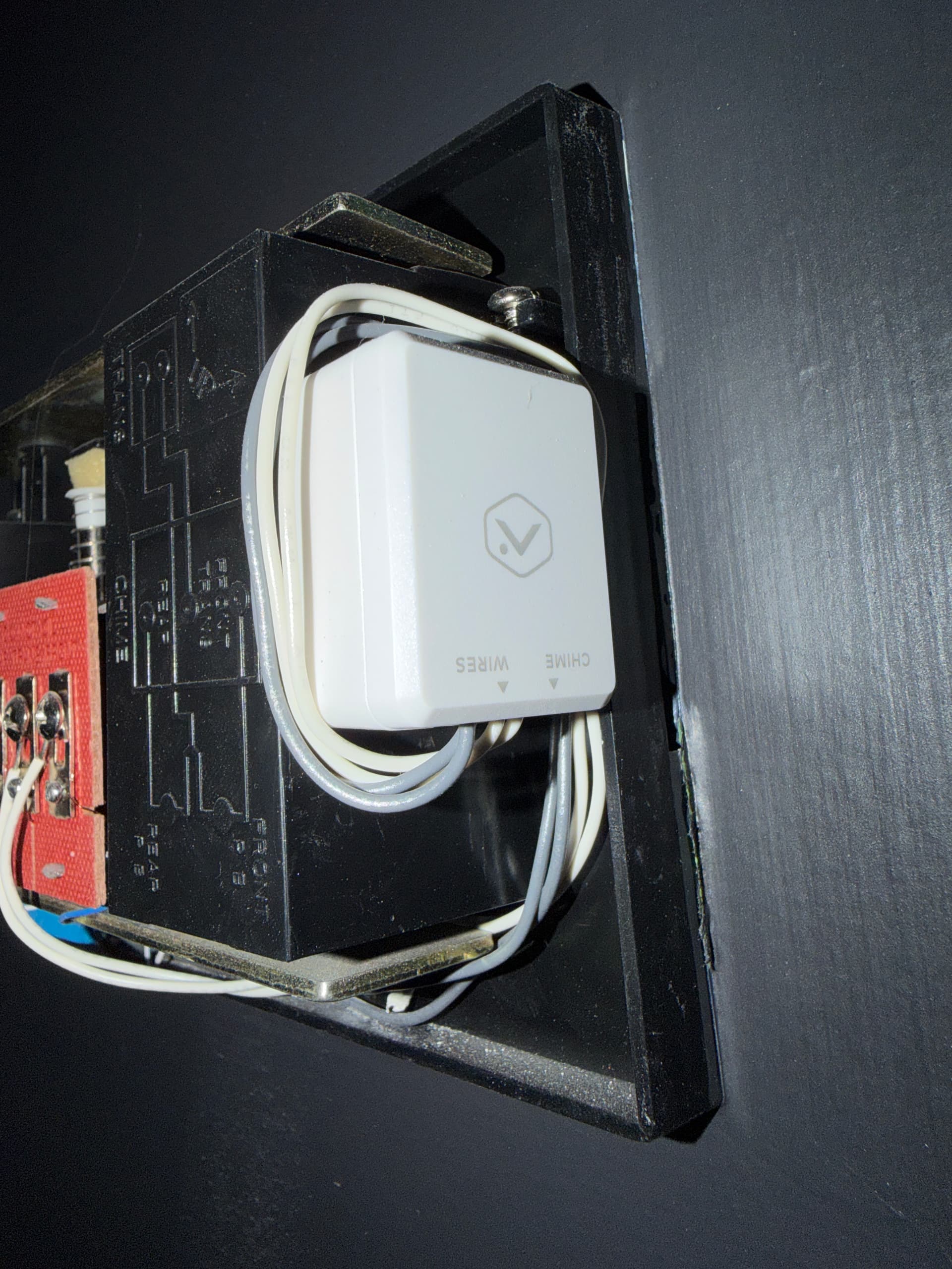

The power module (white box with gray/white wires) is mandatory — it must be wired into your chime box or circuit… did you reuse the one from 770 or purchased a new one that is 775 specific? or it came with one?
That is if you have a digital chime. If you have a mechanical chime you don’t need that. The module for the mechanical chime is included with the doorbell. I bought the module for the digital chime. DIdnt end up using it.
Your current VDB770 settings are set to use a mechanical chime. If that’s the case, you do not need to purchase a separate power module in order to use the VDB775.

If you’re using an Alarm.com power module for the VDB770, it would need to be replaced when upgrading to the VDB775, as the 775 has one specifically made for it.

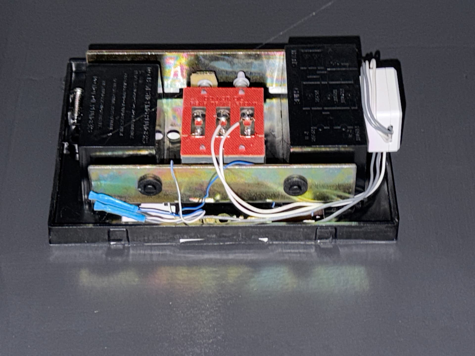

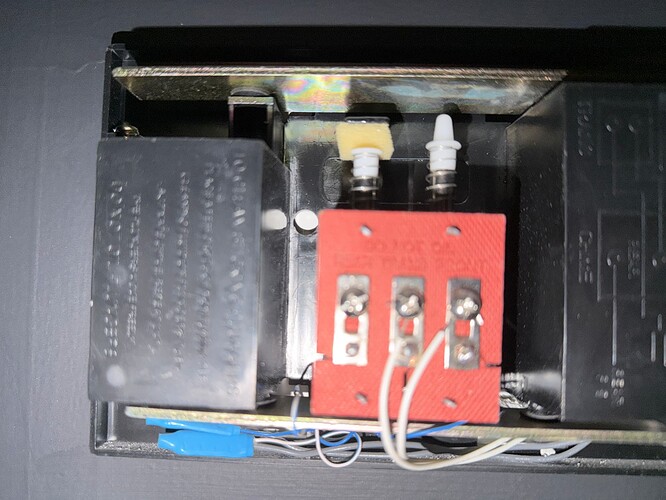

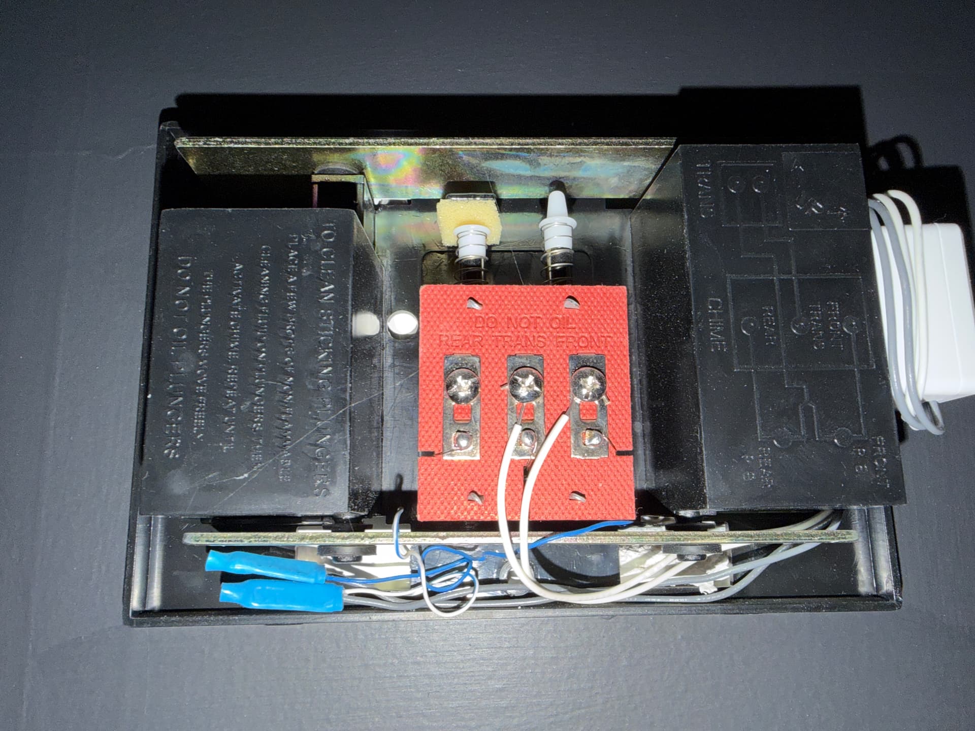

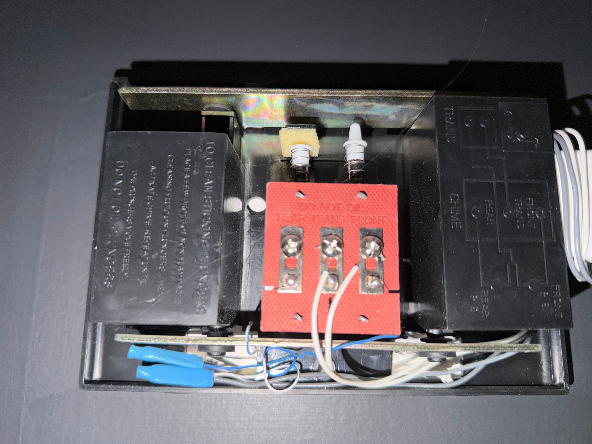

Your previous VDB770 settings showed that you were using a mechanical chime. If you’d like to double-check, could you send us a photo of the inside of your doorbell chime? We can help confirm if it’s digital or mechanical. You can also send that to us via private message here or via email to support@suretyhome.com if you’d prefer.
