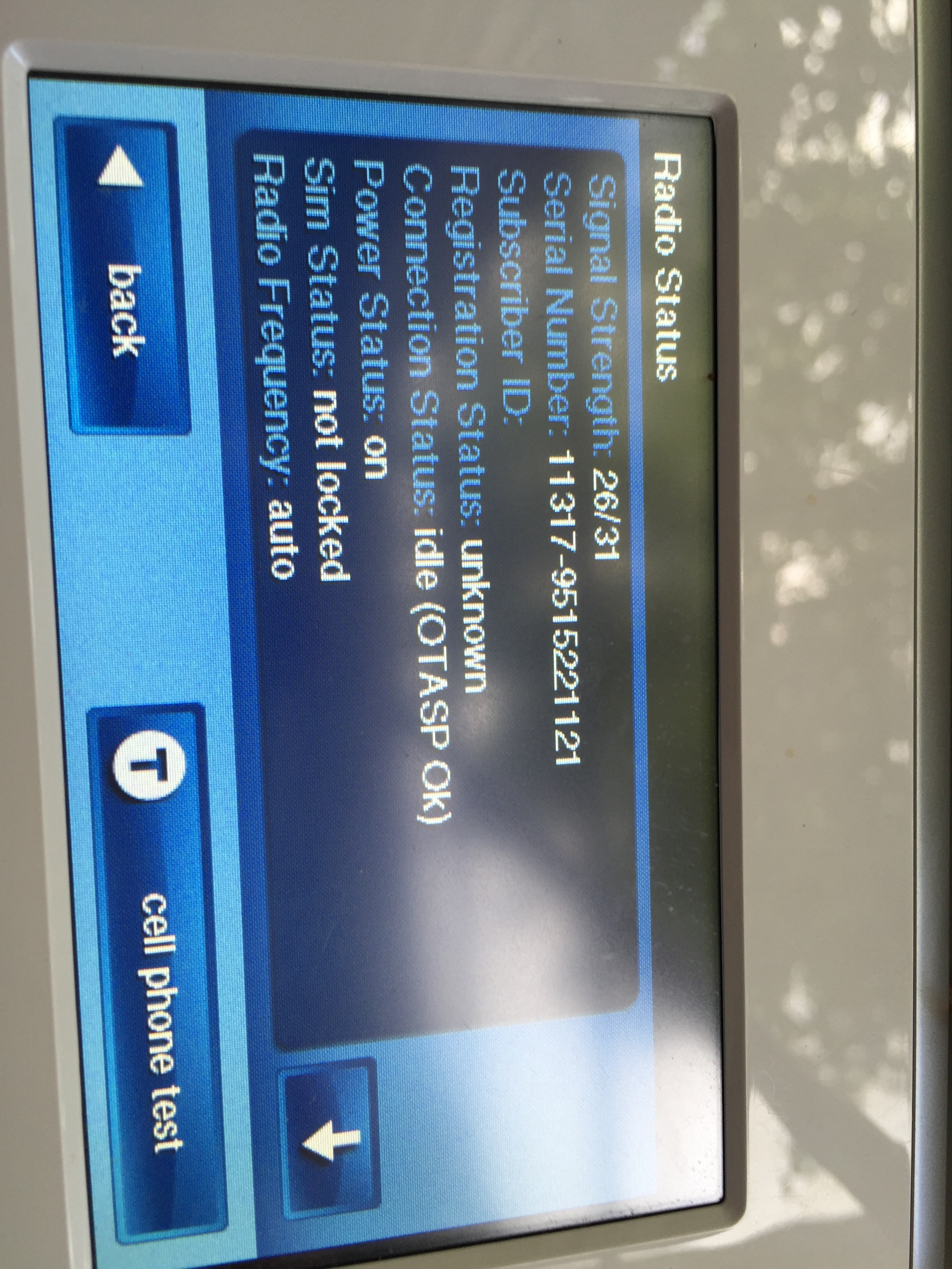

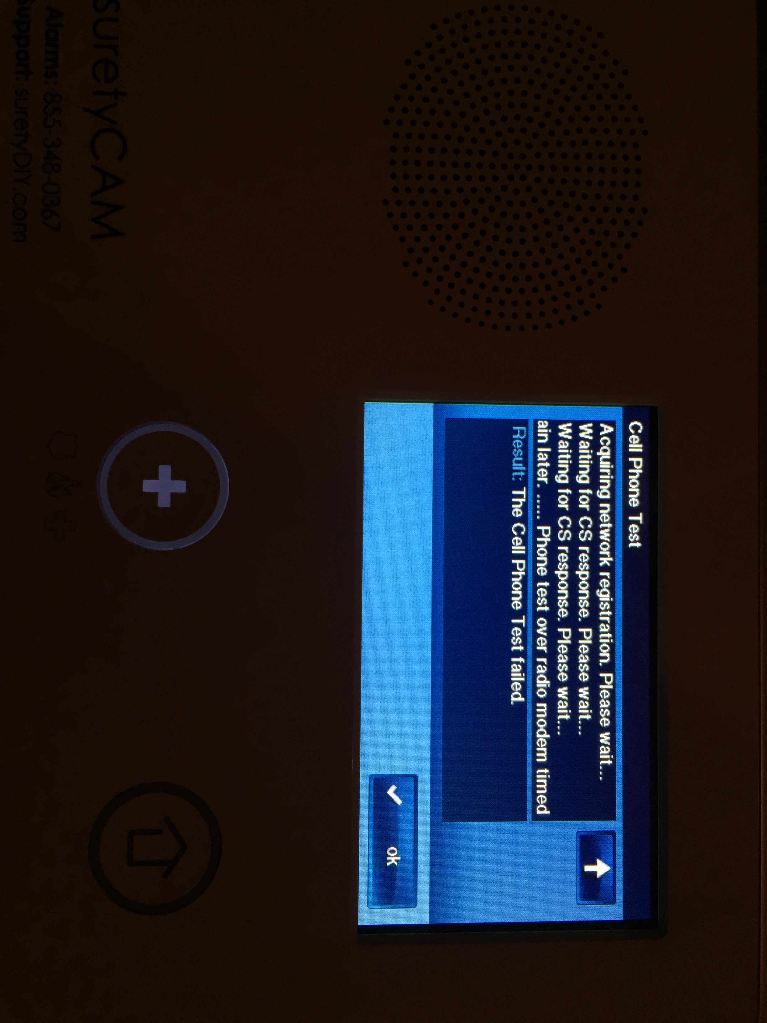

When attempting the cell test, it says phone over radio modem times out…please try again later.
The registration status keeps flipping between unknown and registered.

The error message, says your cell module is no longer registered. You cannot connect to alarm.com with an unregistered cellular module
If the module is in fact registered… then properly install the antenna. Module may have become damaged, and may need replacement.

I’ve moved it upstairs near a window, and the registration status still flips between unknown and registered
It’s like it can’t maintain an extended connection long even to sync/update even the time on the panel.

3G CDMA Verizon module signal is excellent. Relocating panel will have no affect. Either a tower issue or module issue.
If I were to hazzard a guess, I would say it is a tower issue, you may be without connection to Verizon for another hour, another day, another month, etc.
I suggest you consider replacing the module with the AT&T GC3GA-A module as suggested above (if available in your area. You can check it here: http://suretydiy.com/alarm-com-cellular-coverage-check/)
