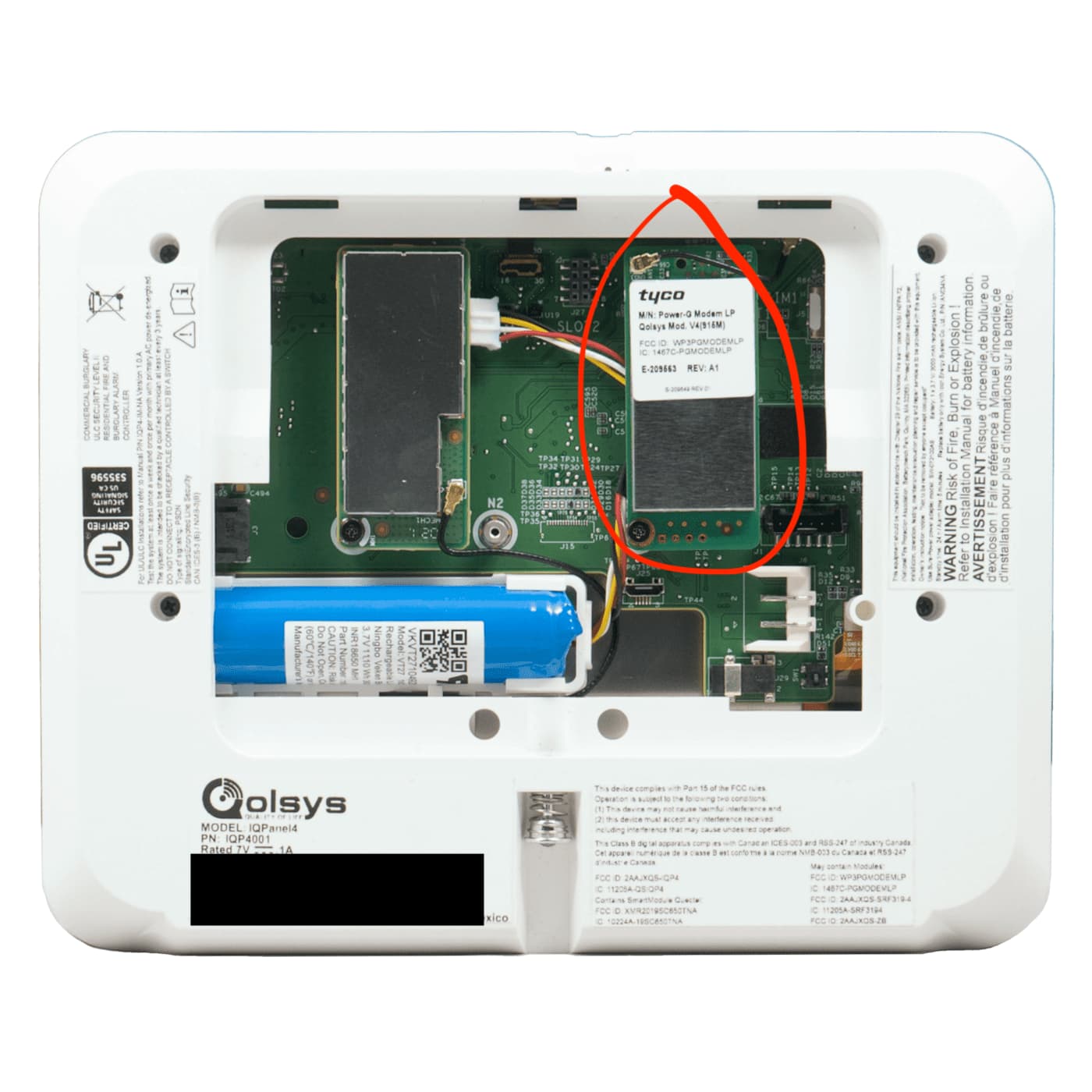

You can also take the panel off the wall and look at the back. The PowerG card should be visible. Is there one installed?
(Example photo)

The IQP4088 is a custom model for a certain dealer I believe, and based on user reports it is installed without a PowerG card, so that is expected for the model, though you can add a PowerG card to it as it still has the port for it.
