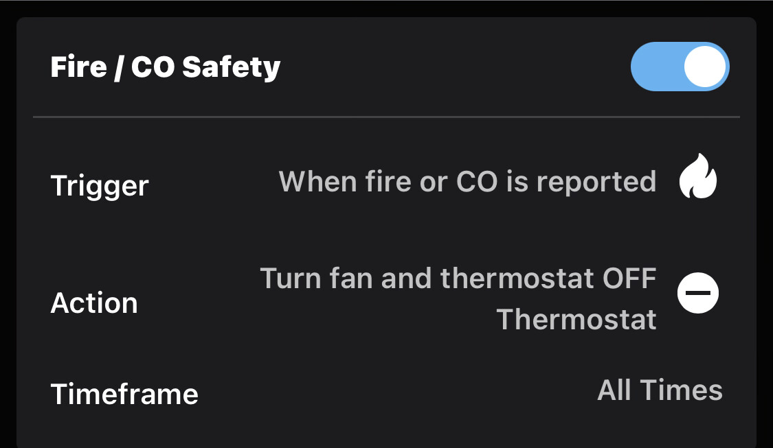

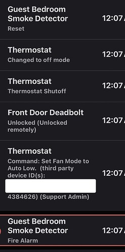

Alarm.com now supports turning off the Ecobee Smart Thermostat Premium (and possibly other versions) during a smoke, fire, or CO alarm. I also have my Front Door Deadbolt set to automatically unlock during a smoke, fire, or CO alarm.
