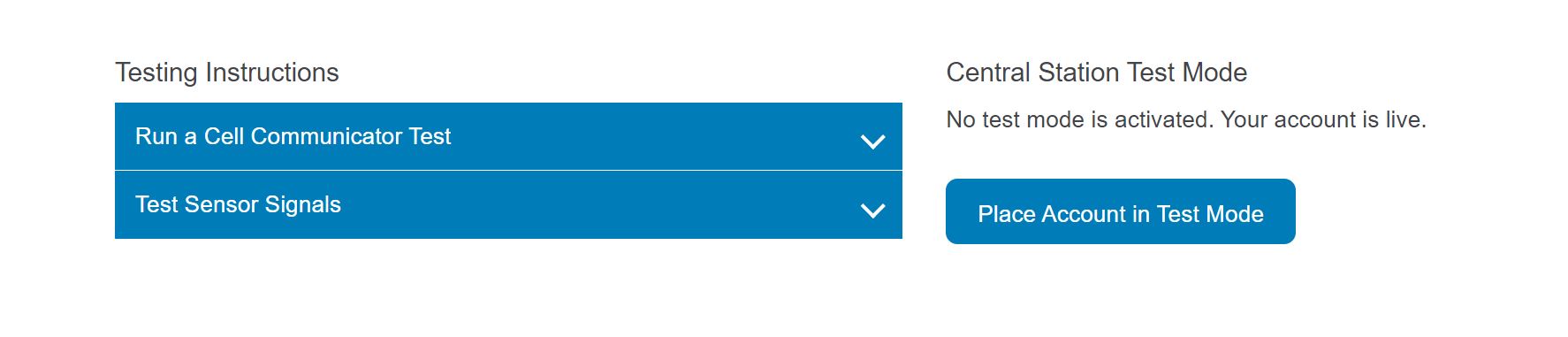

Test My System Tab
From here you can review how to Run a Cellular Communications Test, Test Sensor Signals, and Place your 24/7 Professional Monitoring account on Test Mode, to avoid dispatch when testing/working on your system.

You can place your 24/7 Monitoring Account on Test Mode at any time to avoid dispatch on alarms.
When placing the account on test mode, the alarm system will still trigger an audible alarm (and signals will be sent to the monitoring station, but they will not be acted on by operators.
This mode is recommended when testing your system, or when troubleshooting.
There are two ways to place your monitoring account on Test Mode:
Surety Login
To place the system on test mode, login to your Surety …
