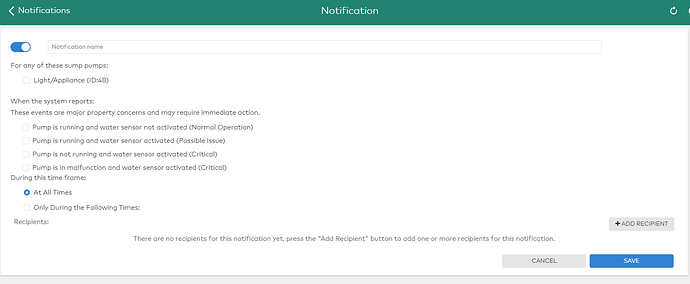

You can then create notifications for the sump pump:
Ok, Thank you Jason. I did saw that tutorial. Al list I can use existing sensor I have. Does it appear in ADC add as a pump or something? I tough I saw that somewhere previously? do you have any screen shots?
