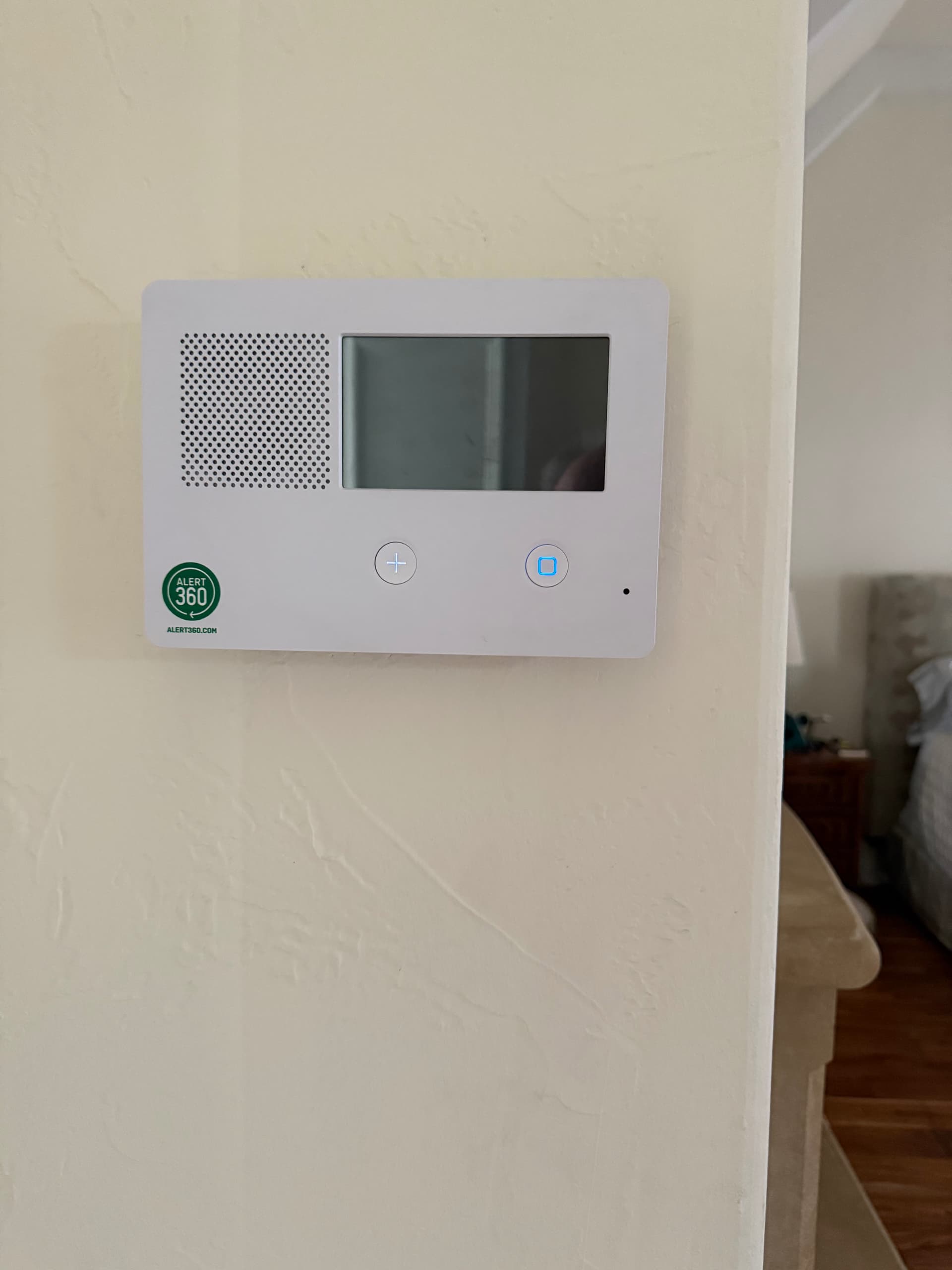

I had recently discontinued service with alert360 and want to set up with surety. I have the panel 2gig-g2ce-345 about 50 various sensors and 8 cameras.
Do I still need the IMEA number? And if so how do I get it? The panel looks diff then the one in your video and I don’t want to set off a tamper alarm without being able to shut it off.

Could you send a picture of the panel so I can better give you instructions?

There’s no IMEI field, but there is S# [removed by admin]
Sub ID [removed by admin]

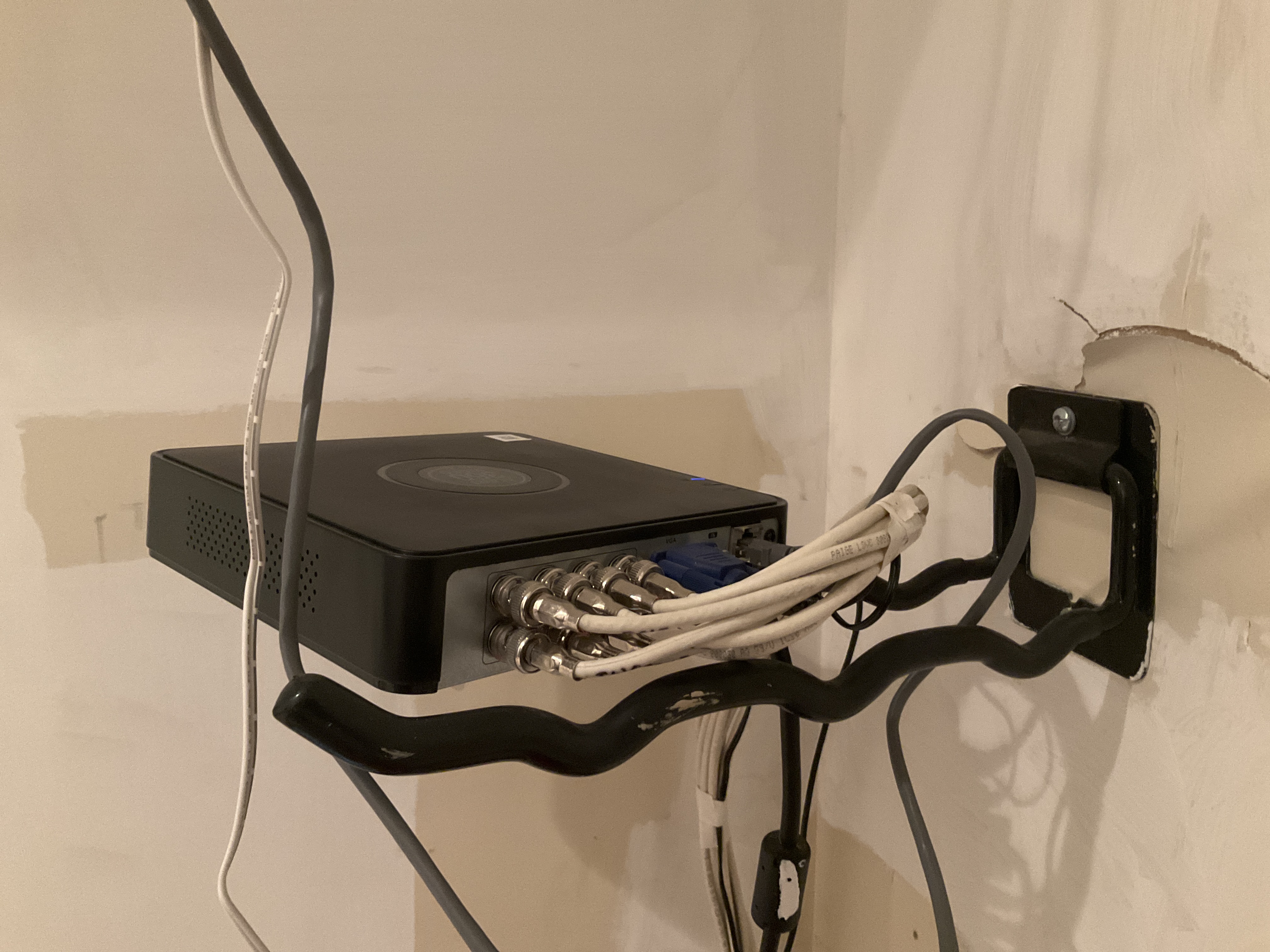

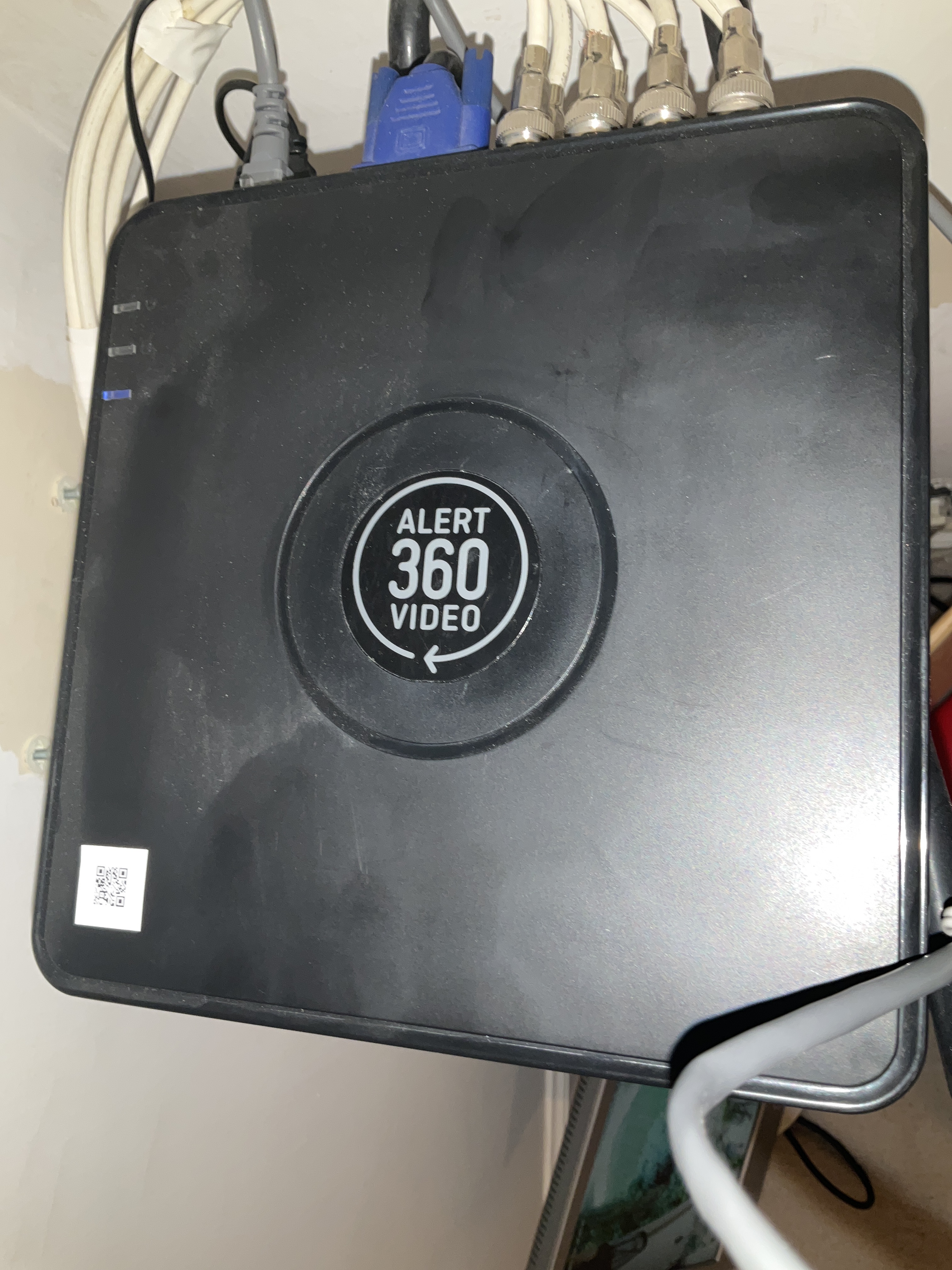

The cameras are hard wired to a DVR.
Here are the pics.
Thanks for the help!

I did check your panel IMEI and you can activate it with one of our plans. It is unregistered. The IMEI is the Serial Number [removed by admin]

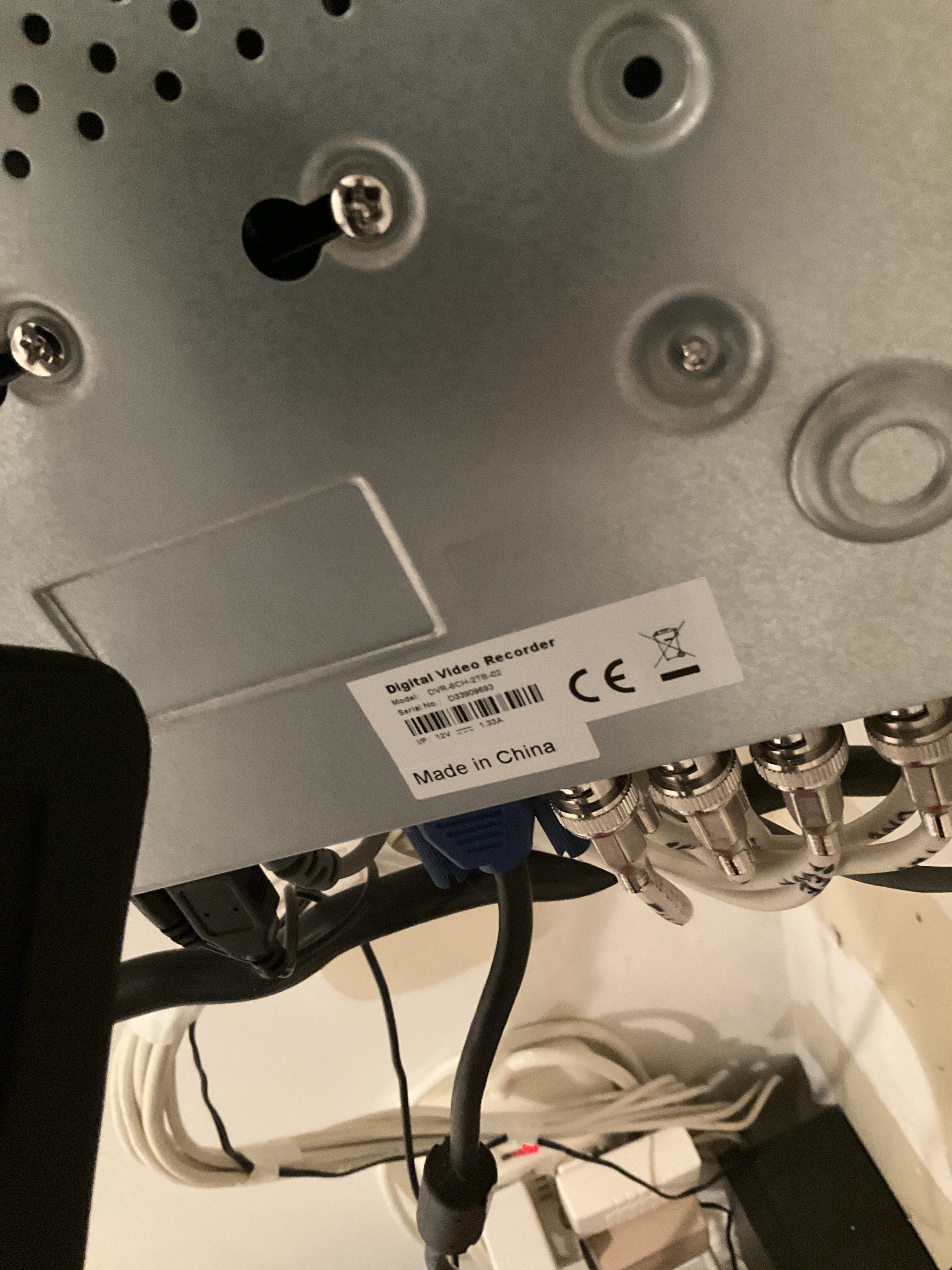

To clarify, the DVR in the image above is not Alarm.com compatible and could not be used with service. Based on that, you may not have compatible cameras but we can confirm if you can provide part numbers to the cameras. If you are unsure of the part number, feel free to submit a photo of the camera for identification.

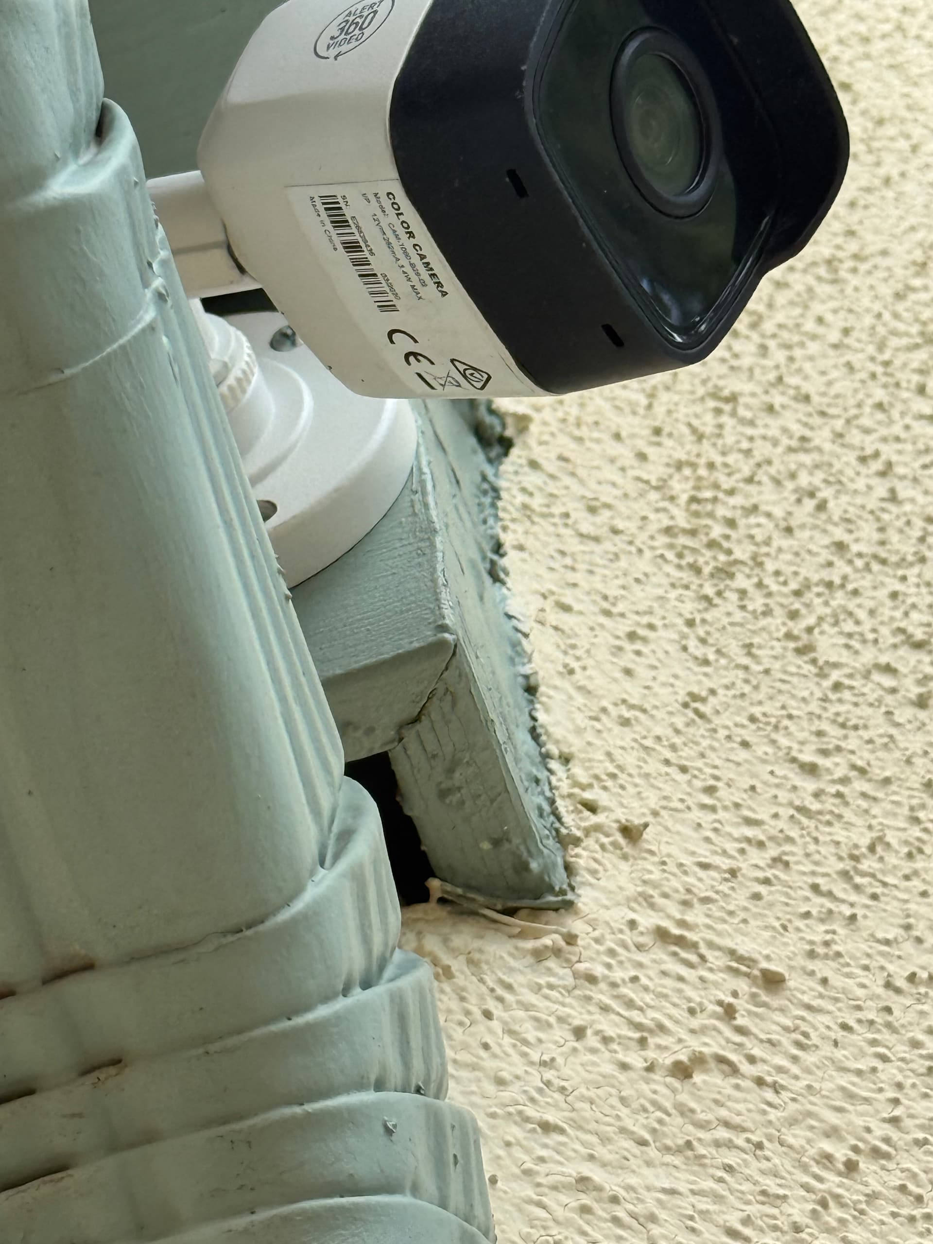

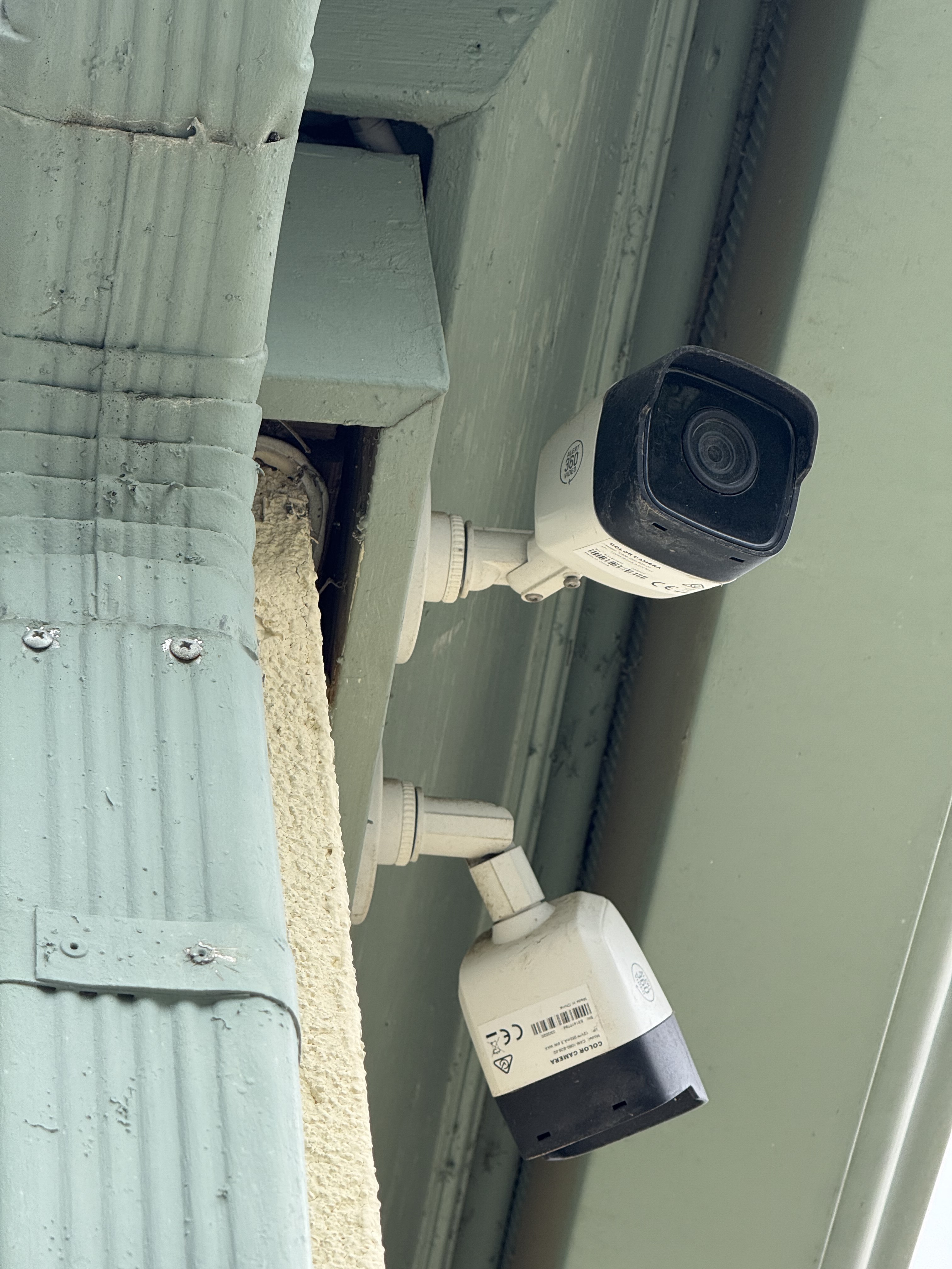

I am using alert360 cameras, which uses alarm.com, but seems to running thru gaurding vision website.
Here are the camera pics: hard wired to dvr pics above.
By the way the cameras are still working thru the alert 360 app. For now….
I posted pictures of some of the cameras, I have 8 total they seem to be going to a guardian vision web service.
In order for cameras to connect to Alarm.com, they need to be unregistered. This means disconnected from the previous Alarm.com account.
I’m not showing any cameras from Alarm.com that look exactly like that unit. Its possible that Alert360 cameras are proprietary.

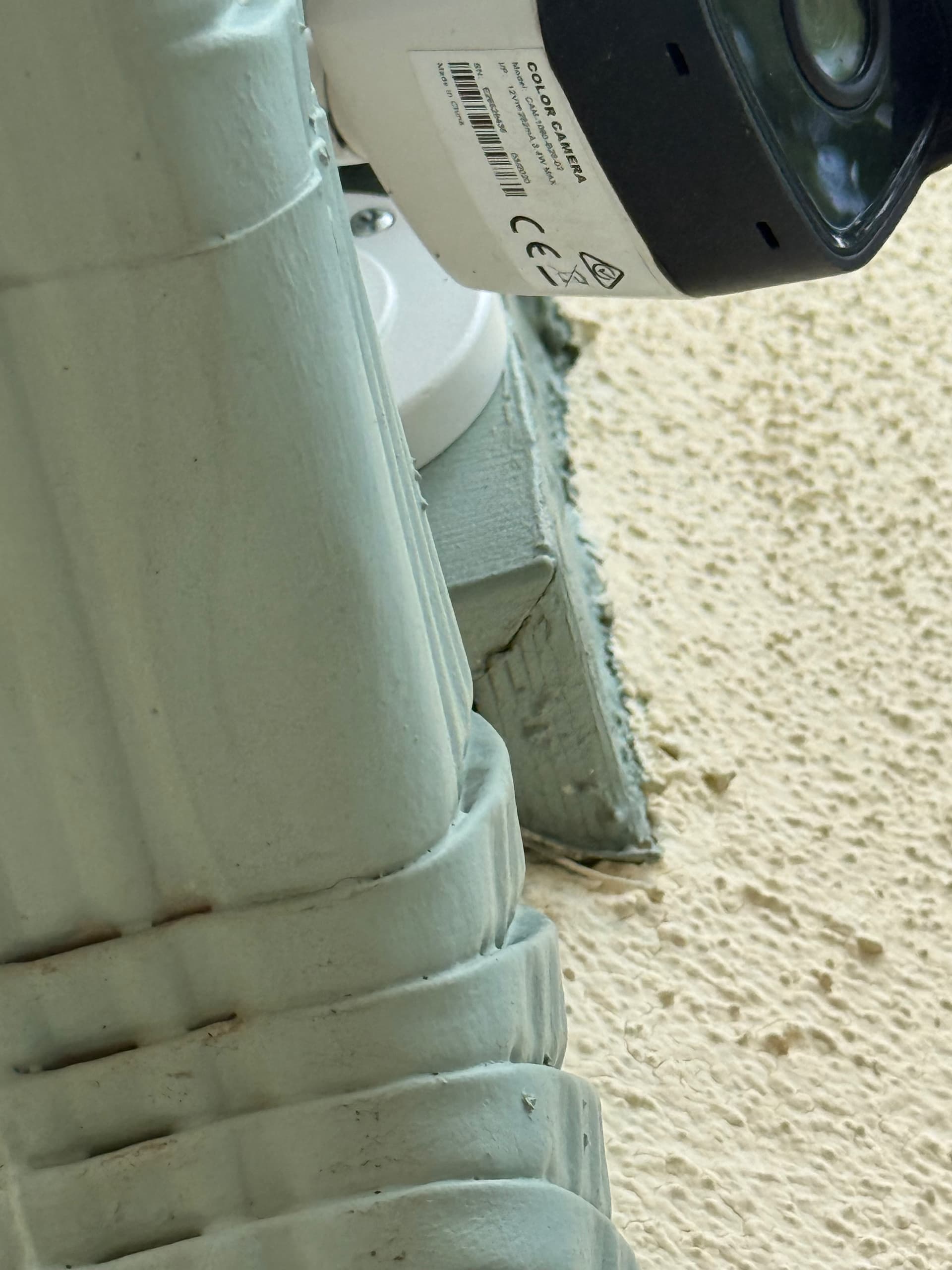

Can you get a clearer picture of the label?

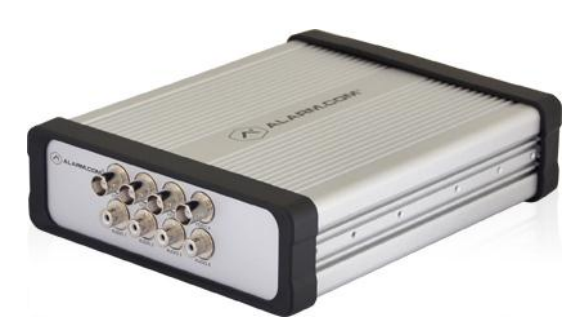

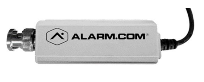

What’s pictured above are analog cameras and an analog DVR. If those are working through Alarm.com then you must have an Alarm.com video server that converts analog video to IP video and sends it up to Alarm.com. I haven’t seen those in a long time.
Do you have anything like these in your camera setup?
If not, I don’t think it can be working with Alarm.com.
nope, don’t have those, well that sucks… At least I got a pic of the camera label sort of…
here it is

can’t see the cameras except for the alarm360 app which appears to be guardian vision app rebranded by alert360. The DVR appears to be a Hikvision and it seems they also have an app.
Those would be separate from Alarm.com then.

Since those cameras are analog, they may be standard definition (usually 480p). Do you happen to know their resolution? What’s the model # on the camera? It’s blurred in the pic.

But replacing 8 cameras can be a lot of work and expensive. If you’re happy with your cameras as is, I wonder if they’ll still work without Alert360? That’s a local DVR. Does the app you use to connect to it go through their servers or directly to your DVR? If direct, it might keep working.
