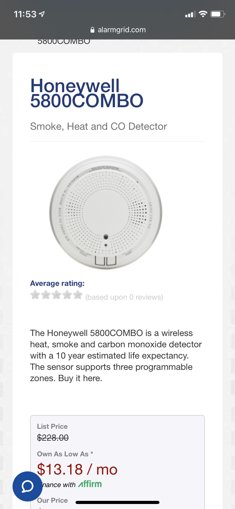

Thanks! So no smoke/co combo that work with my 345 model?
I’m not sure if the Honeywell 5800 series smoke and co detector would work or not since u have a 345 panel
There is a Honeywell 5800Combo as the other poster here suggested, but a couple caveats:
- It will probably work, but it is not on the officially supported sensors list.
- It is expensive. It is more expensive than just getting an individual Smoke Detector and CO detector in most cases.
Wow, no kidding on that price. Thanks!
