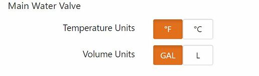

Units of Measurement
Temperature Units - Fahrenheit or Celsius
Volume Units - Gallons or Liters

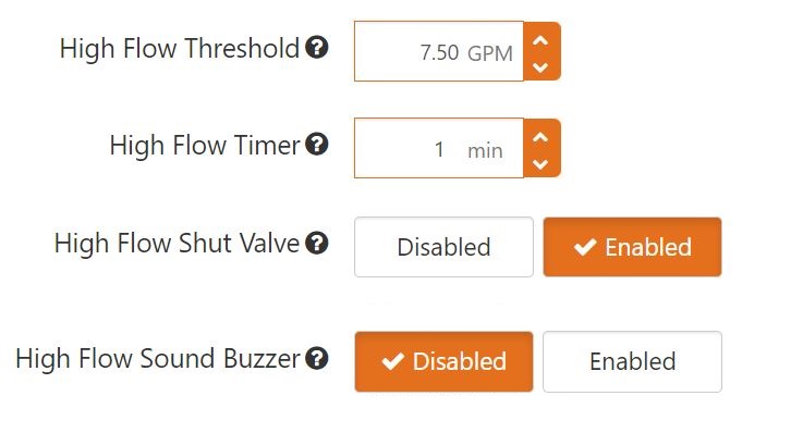

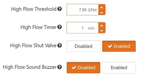

High Flow Settings
High Flow Threshold - Measured in Gallons Per Minute (GPM) .75GPM to 26.50GPM in .25GPM increments
  • If the water meter detects flow above this level for the duration specified by the High Flow Timer setting, it will be considered unexpected high flow
High Flow Timer - Measured in Minutes 0 to 100 in 1 minute increments
High Flow Shut Valve - Enabled or Disabled
  • If unexpected high flow is detected, the valve will automatically close
High Flow Sound Buzzer - Enabled or Disabled
  • If unexpected high flow is detected, the meter’s buzzer will sound

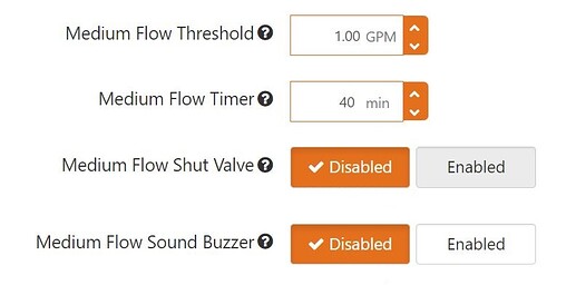

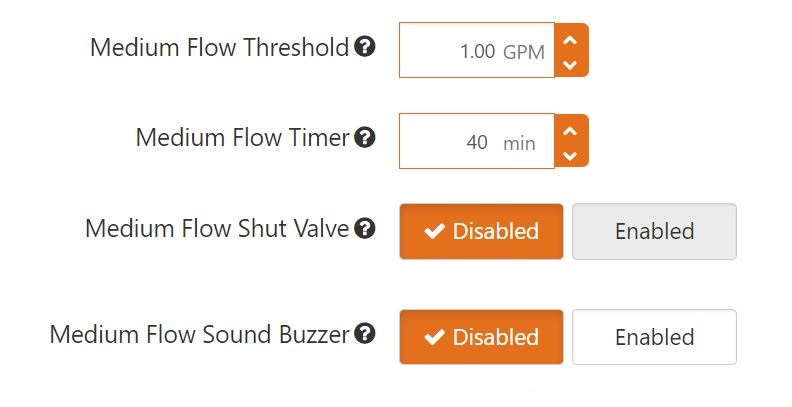

Medium Flow Settings
Medium Flow Threshold - Measured in Gallons Per Minute (GPM) .75 to 26.50 in .25 increments
  • If the water meter detects flow above this level for the duration specified by the Medium Flow Timer setting, it will be considered unexpected medium flow
Medium Flow Timer - Measured in Minutes 1 to 240 in 1 minute increments
  • If the water meter detects flow above the Medium Flow Threshold for this duration, it will be considered unexpected medium flow
Medium Flow Shut Valve - Enabled or Disabled
  • If unexpected medium flow is detected, the valve will automatically close
Medium Flow Sound Buzzer - Enabled or Disabled
  • If unexpected medium flow is detected, the meter’s buzzer will sound

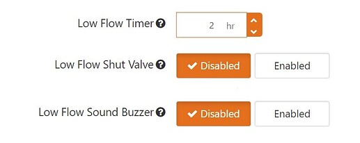

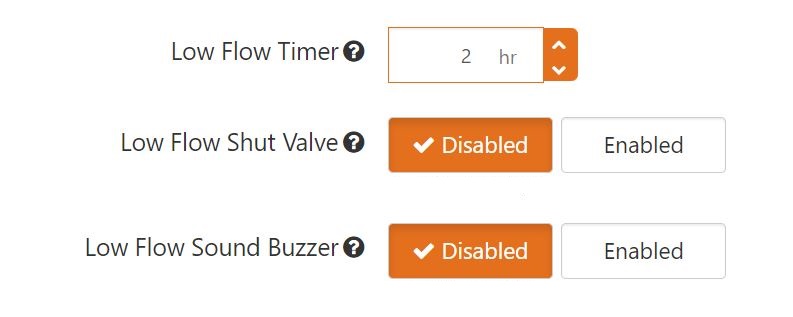

Low Flow Settings
Low Flow Timer- Measured in Hours 1 to 24 in 1 hour increments
  • If the water meter detects any flow for this duration, it will be considered unexpected low flow
Low Flow Shut Valve - Enabled or Disabled
  • If unexpected low flow is detected, the valve will automatically close
Low Flow Sound Buzzer - Enabled or Disabled
  • If unexpected low flow is detected, the meter’s buzzer will sound

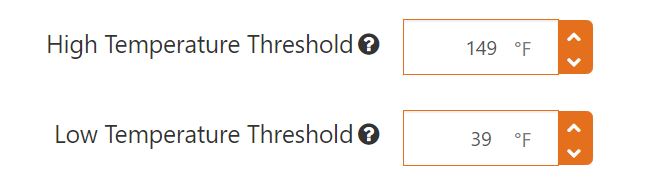

Temperature Threshold
High Temperature Threshold - Measured in degrees 68F to 149F in 1 dgree increments
  • A water temperature above this threshold will generate an alert
Low Temperature Threshold - Measured in degrees 32F to 50 F in 1 degree increments
  • A water temperature below this threshold will generate an alert
