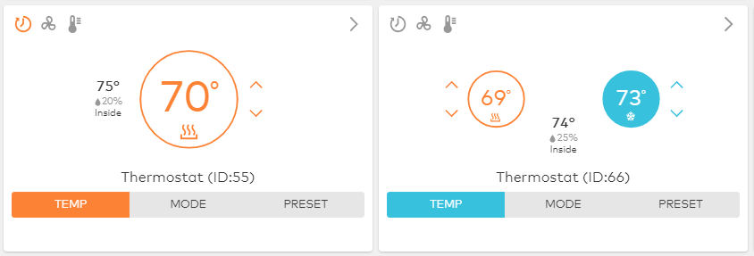

The following image displays two thermostats on the home page of the Alarm.com Website. The first thermostat is in heat mode with a 20% humidity reading. The second thermostat is in auto mode with a 25% humidity reading:
