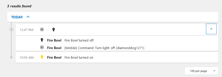

Light switch activity is not an option to trigger notifications at this time, although I’ve actually recently pushed this as a request to ADC.

It is exposed to sun, so maybe it heats up and gets “soft” and triggers. I switched it with another one to see if it does it again and also added 4 rules to turn it off at various time daily as a safety since it has to do with fire.
There is no one around this switch as its by the swimming pool equipment and no one goes by that except me.
