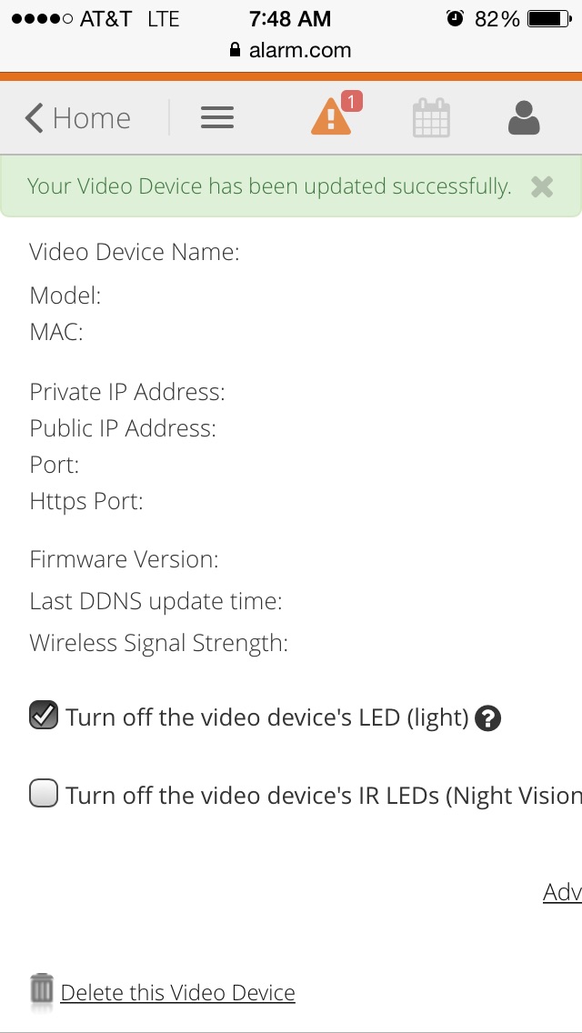

Do your settings match these? If yes, then try a RESET again. If the IR is not activating, then camera may be damaged.
IR should definitely kick on if you haven’t instructed it not to. We can try the firmware push if the camera isn’t losing connection. Worth a shot to see if you get different activity.
