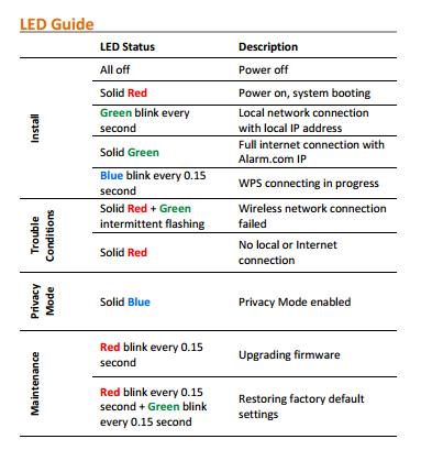

Delete the camera from your account, then reset by holding paperclip/toothpick to reset button while powered for 45 seconds. See LED guide below for LED indicator meanings.

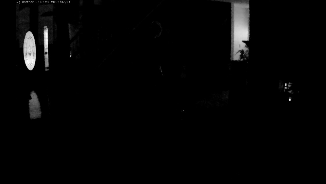

Last night I deleted the cam from the account, reset to factory settings, re-added to the account and created new rules. At this point all the rules appear to be working. HOWEVER, I have a new major problem and I’m hoping it can be corrected with a new firmware push. Even before I did this factory reset, I have been noticing that I could not see hardly anything on the camera in low lighting conditions. So last night, I decided to look further into this. I turned off all the lights, and I could not see the red glow of the IR things at all whatsoever. I reviewed several recorded low light clips and it’s very dark, except on occasion it will get very bright for a split second and then go dark again. It’s as if the IR decides to work for a second and then goes back off. My sensitivity is set at normal, but I have also tried it on low. Is this the problem that you were referring to when you spoke about the latest firmware update? At the moment, I have zero night vision. I’ll try to attach a screenshot below.
