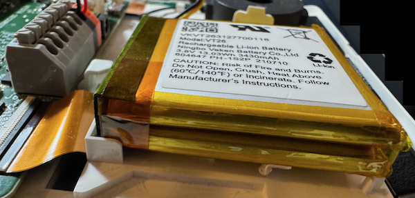

Is that battery swollen at all?
I would leave it plugged in for a 4 or 5 hours first to verify the battery is charged up enough. Low charge on a lithium battery pack is actually not that low on voltage. The voltage curve drops off abruptly as the battery is drained completely.

Hard to tell if the battery is swollen, as I’ve not seen this battery before in the flesh. Maybe like a little air is trapped under the label? But not ‘blown up’ like I’ve seen a laptop battery get.

and the 3.8v battery is giving 3.42v. So yes, maybe it is low!!
I will leave it plugged in overnight and see what happens. Thank you!
Pic of battery:
IMG_1596
