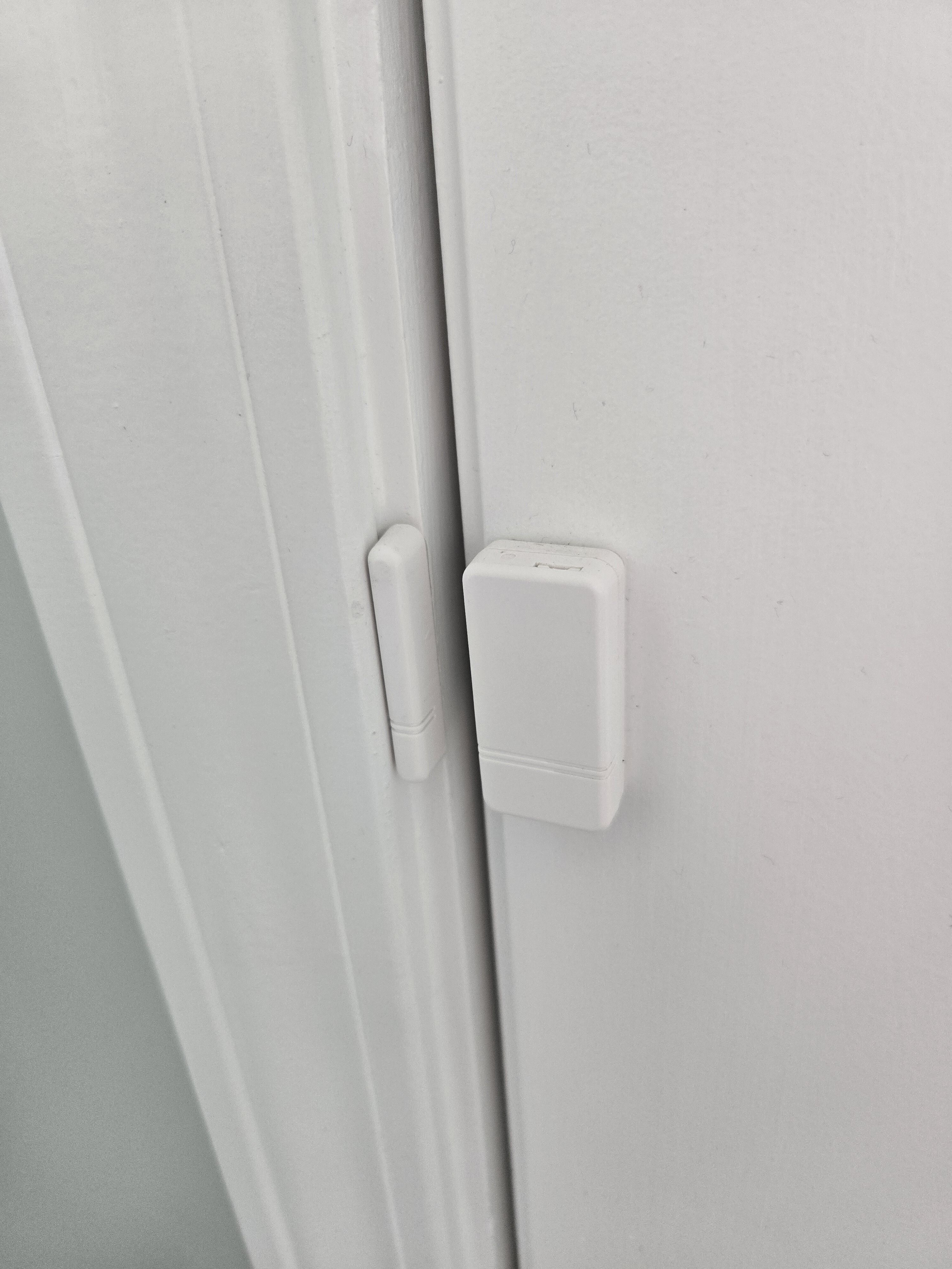

How to reset door sensors

To better assist you, what is the model number of sensor you are referencing? If you do not know, you can submit a photo to us.

That looks like a Qolsys 319.5Mhz Sensor. The sensor itself does not need to be reset in order to be learned into a new panel or reenrolled into a panel if it was deleted at one point.
Here is a programming guide for Qolsys with 319.5 sensors.
This guide covers some common programming choices for the Qolsys IQ Panel 2 and 2+ alarm panels.
Below is the pathway taken at the panel to access sensor programming. We recommend choosing the Auto Learn Sensor feature.
[Qolsys-Senosr-Programming]
After choosing Auto Learn Sensor, the panel will begin to listen for the sensor’s signal. It is at this point that you would tamper or trip the sensor to initiate the pairing process.
