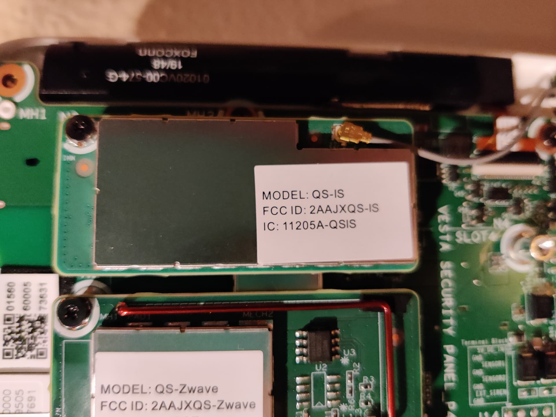

Sorry for thread-jacking, but was there any resolution to this? I’m having the exact same problem with the three ADC-IS-100-LP that worked flawlessly on a Simon XT (yes, I deleted them from the Simon before trying them on the Qolsys). The panel is at the latest SW version 2.6.2. FWIW, I’m attaching the image of the daughter card I replaced the Power-G one by.
