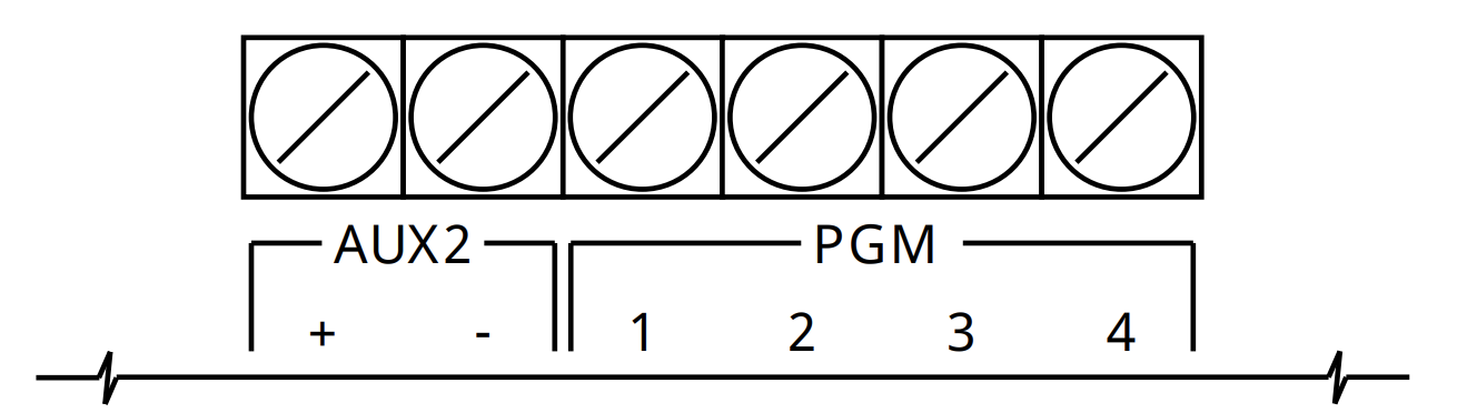

How Do I Wire PGM Outputs?
Wiring PGM outputs depends on what you’re connecting them to and using them for. It’s important to understand what you’re doing and how the circuit will work before wiring. Always wire with the hardware powered off.
A common application is to power a device (like a relay or buzzer) with 12V auxiliary power but only when the PGM is activated. To do this you would connect the
terminal on the device to +12V aux power on the panel, and connect the
terminal on the device to the PGM. When the PGM is activated, it connects to ground which completes the circuit and powers the device.
See your control panel installation manual for detailed examples on wiring PGM outputs.
