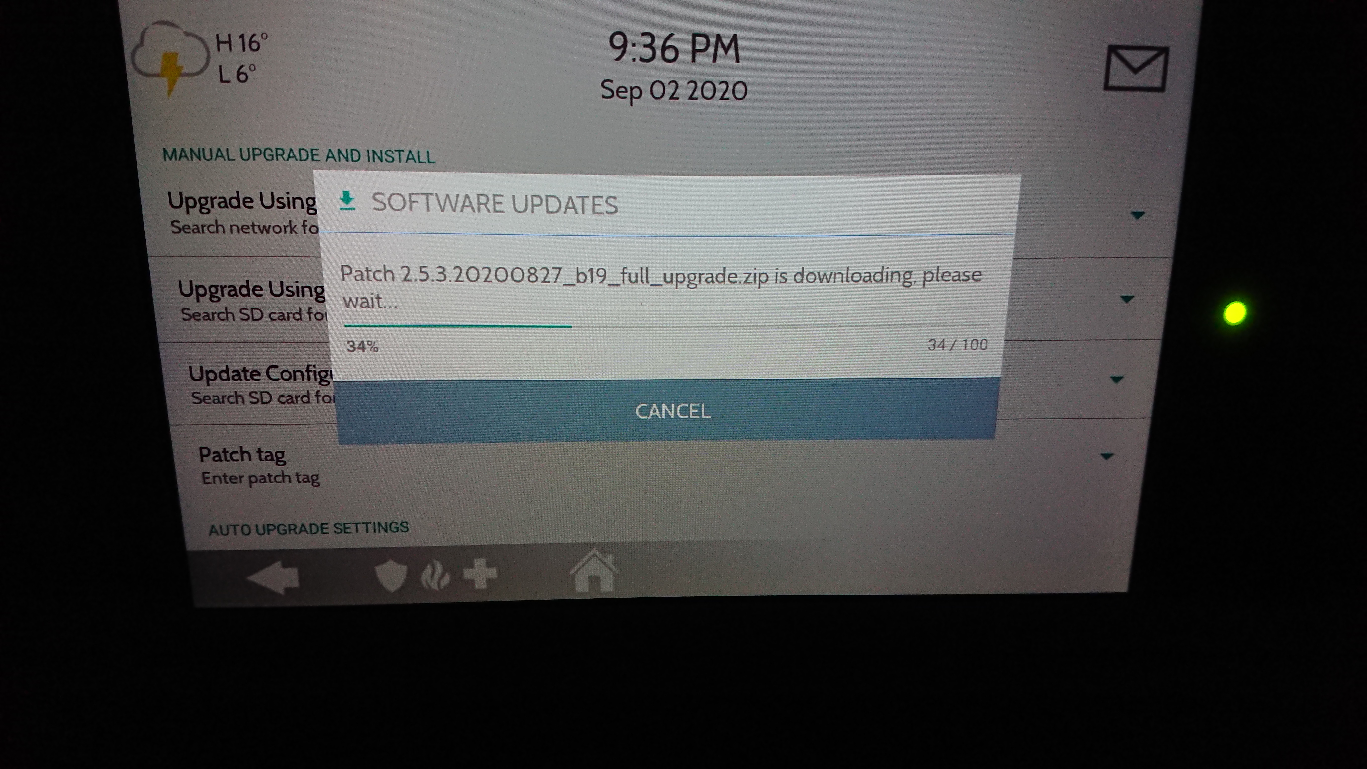

As it’s now officially released, can somebody confirm that the patch tag log as shown in my picture above, is the same is the officially released one? I just want to make sure I haven’t downloaded the older buggy one. I guess I could try to re-download it however I want to limit the amount of firmware updates the panel gets because that’s when it’s most vulnerable. Thanks!
I can confirm that b19 was last test build that i have tested. if you are able to download that its should be official. I will try to confirm
Yep, looks like it is available for normal download now. I added the TSB and instructions to the firmware thread.
thanks! I currently have the b19 dated Aug 27, 2020 patch installed. If this is the latest, i’ll leave my panel alone!
