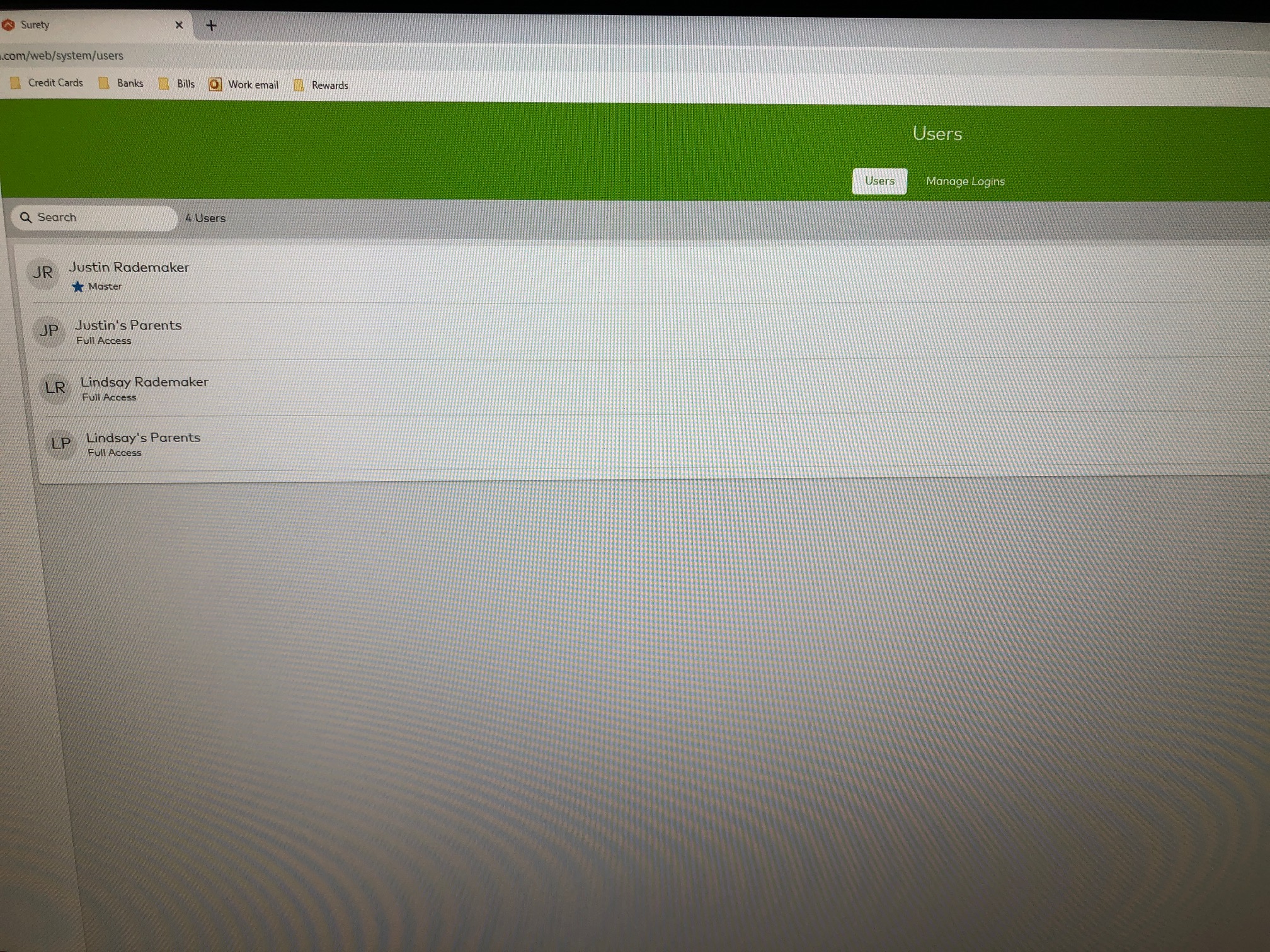

I have tried that… They are not listed on on the users page. They are however listed but not editable when I want to set up an alert. Here is a picture of the users section and me trying to set up a notification.

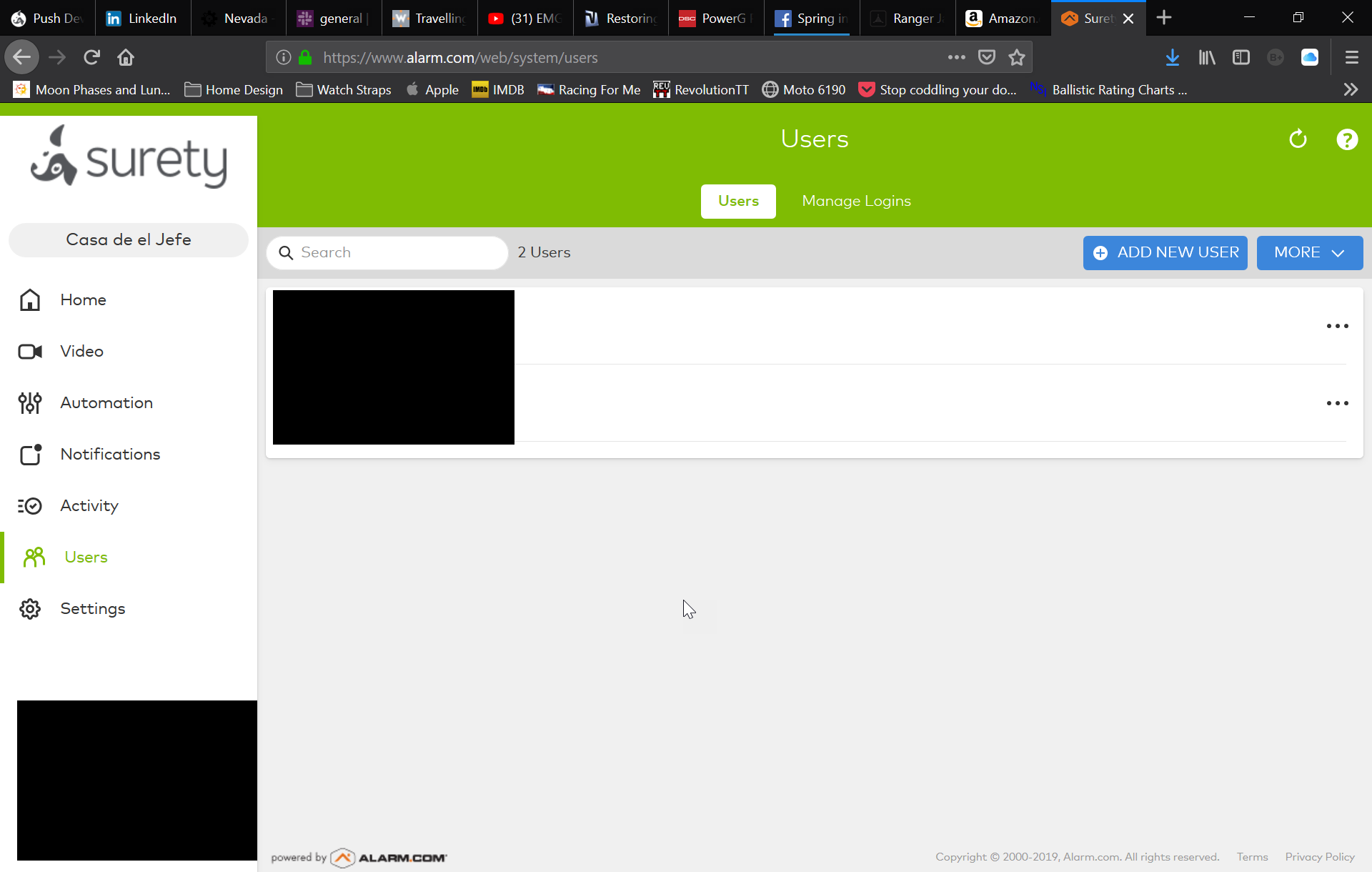

I am able to see a read-only version of that page for your system, and the Push Devices section is definitely there in the Users List.
What browser are you using? In addition to the missing Push Devices section, there are more columns which should be visible. I am guessing this is a browser issue.

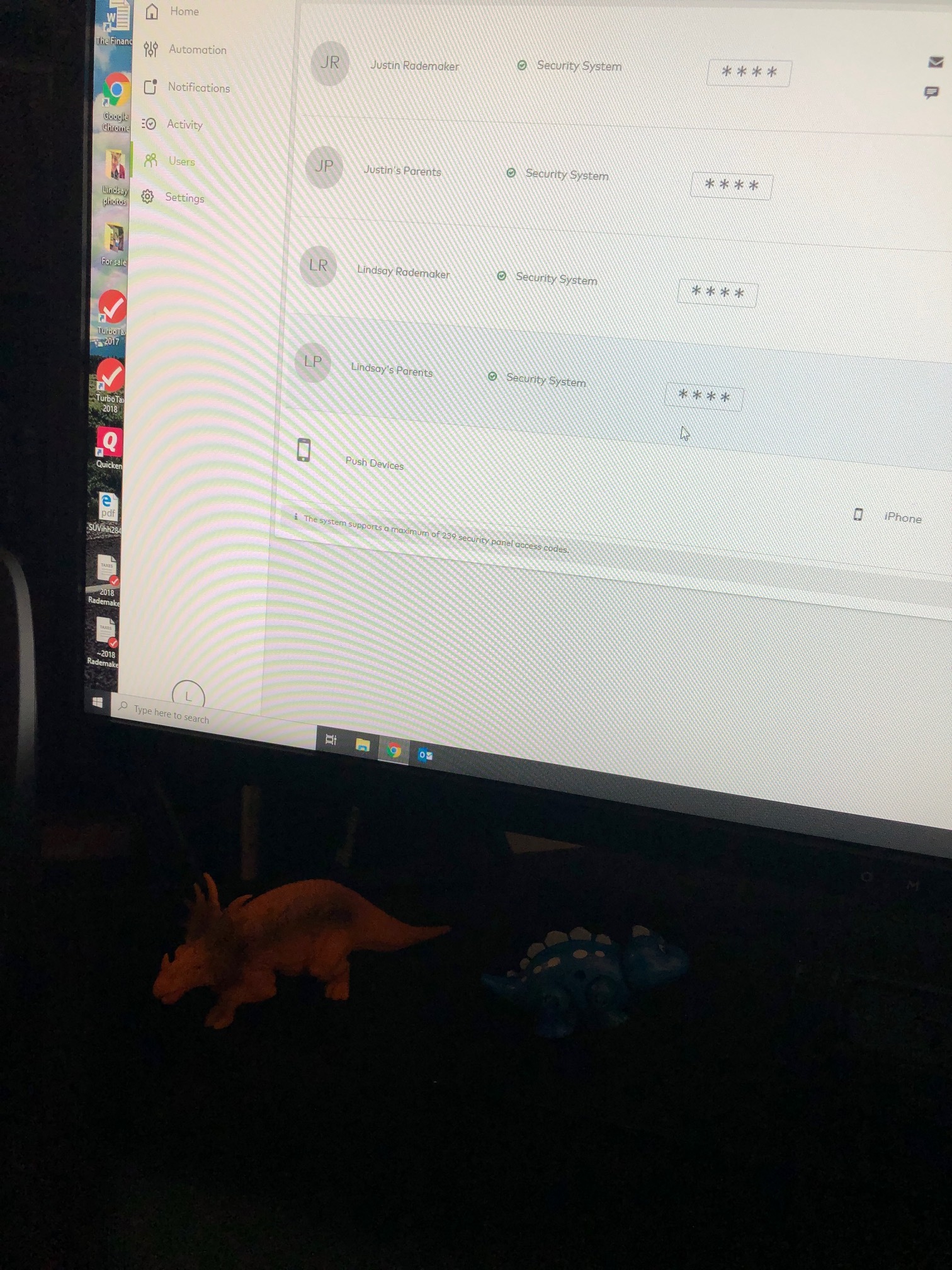

So very strange, I just logged in on my wifes login, which is the secondary one I created this morning, and I was able to delete the push devices… Is there a reason this wont show on the master login but on the secondary one?
Something very strange is that your URL appears to be incorrect. The User page should be at
alarm.com/web/Users/Users.aspx

I am not seeing what you are seeing when I log into my own account (or any demo) on Chrome.
I am using a PC… so with my wifes login I see everything I believe I am supposed to, on the same browser…Is there something wrong with the master login permissions or something??
Edit. On the secondary login it does show the aspx at the end of the url…
It does not on the master login. I tried adding it to the end manually while logged into master and it just says page not found

Doing that just shows page not found… Something about my login adds the word system between web and whatever I click on in the url.
