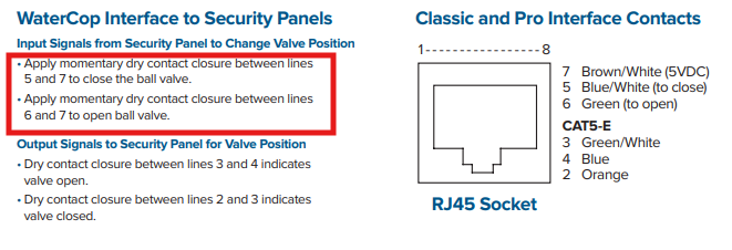

I’m trying to work out the best way to control a Watercop water shutoff solenoid using Qolsys. I see the new PGP-IO9 IO module coming that has output. The Watercop water shutoff can have an aux momentary signal to shut the valve. I’d like to see if I would be able to use the PGP-IO9 to trigger the aux input to close the valve. What I can’t determine from the documentation is whether there is any control on the output behavior to make it a momentary switch signal. Do you guys know how that PGP-IO9 output can behave when connected to an IQ4? Can it be configured to send a momentary for a specific duration?

Like I mentioned I need the output to momentarily close a circuit. This would happen when a water tile senses water or perhaps one of the armed modes.
Power would obviously be involved. I don’t think this device is providing voltage.
Do you think I will be able to configure this device to use local rules to trigger a momentary output to close a solenoid water valve?

In this case, no. I need two outputs that provide a momentary closure only. The valve controller wants a momentary contact to signal closure. A separate momentary contact to open. The valve controller takes care of latching the valve. Think of this like pushing a momentary button on a controller panel to close and then another to open.
This io device would be ideal for me because I need the two outputs to control close and open and the two inputs to show indication of closed or open.

What model Watercop are you installing? I looked up the Watercop and the Pro and Classic require a Momentary Dry Contact Closure for both opening and closing which means you wouldn’t need a power supply in the relay.
Pro.
Closing 5v to the input on the water cop controller to open or close is voltage. That voltage would run through the pgpio9.
Do the pgpio9 outputs work like dry contact relays? Both outputs look tied to ground. They aren’t pairs. There are 4 terminals and a ground on the device. In the manual it depicts the ground also tied to a ground plane. If we have two inputs and two outputs they all share a ground. In this way I probably need to use relays and power to get dry contact relays for the output switching. I may be able to use the water cop controller for 5v to power the relays and if 3 is ground tie that to pgpio9 ground.
