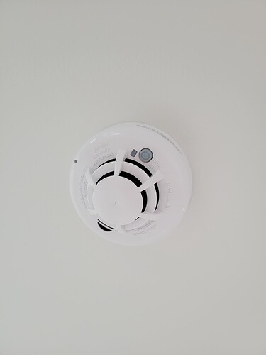

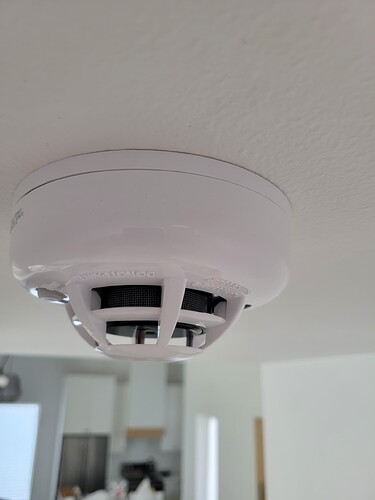

So today at 2:01p I got an alert saying “fire sensor trouble.” Checking the panel I see 2 trouble statuses for my smoke sensor. One says “trouble” and the other says “dirty.” I did what the manual said to vacuum with a small brush head. The manual also says that the trouble will clear after 4 hours however it is now 6:47p and still in trouble condition. To make it worse the thing keeps beeping every 48 seconds, which is extremely annoying! Please HELP!

Yes, the panel gives me the detector dirty alert. The led light and sounds from sensor agree with panel. Can you please send the commands again? I had removed the batteries on the sensor to stop the chirping for the night. And I just turned it on again. The panel shows that the sensor was restored because it was in failure status, and it is back again showing 2 alerts for the sensor the first of which is “trouble” and the 2nd, “dirty”

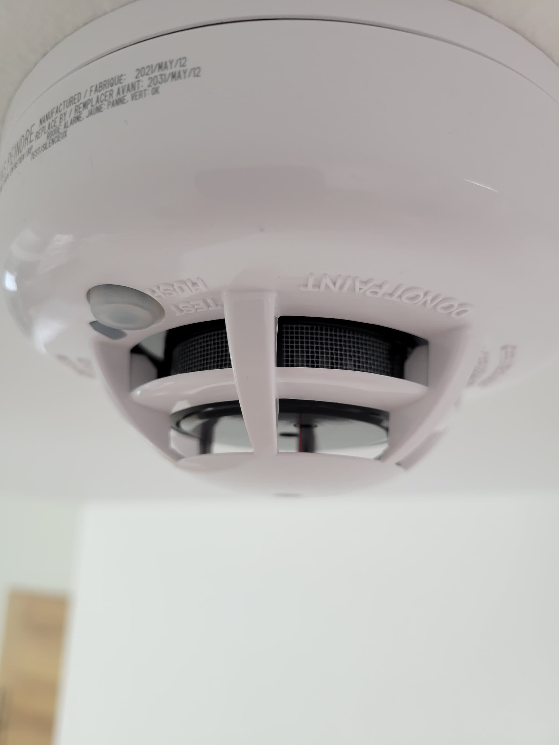

Flash is every 8 sec. Chirp is every 48 sec. I already vacuumed as per manual. Manual said that it would clear after 4 hr.
Is there a way to reset the sensor? It doesn’t look like the sensor is dirty or dusty.
You can reboot the sensor by removing the batterys for 30 seconds and reinserting them.
If the sensor is still reporting a dirty sensing chamber and the chamber has been cleaned per manual instructions, then the sensor may be faulty and in need of replacement.
