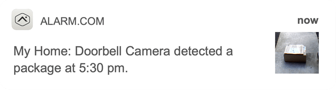

- A delivery notification is a package alert with a thumbnail of the parcel
- A removal notification is a person alert with a thumbnail of the individual

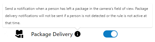

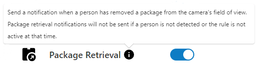

- In Notification triggers:
- Click the Package Delivery toggle switch to enable notifications when a person has left a package in the camera’s field of view.
- Click the Package Retrieval toggle switch to enable notifications when a person has removed a package from a camera’s field of view.
- Configure the recording rule as desired.
- Click Save.

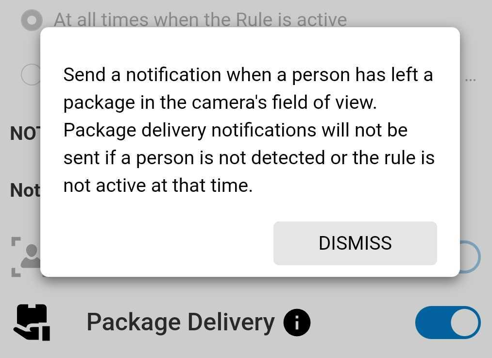

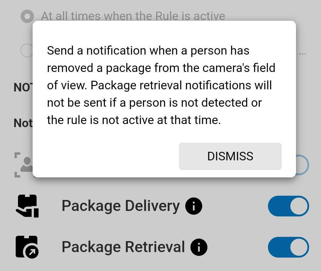

- Tap the Package Delivery toggle switch to enable notifications when a person has left a package in the camera’s field of view.
- Tap the Package Retrieval toggle switch to enable notifications when a person has removed a package from a camera’s field of view.
- Tap Save.
