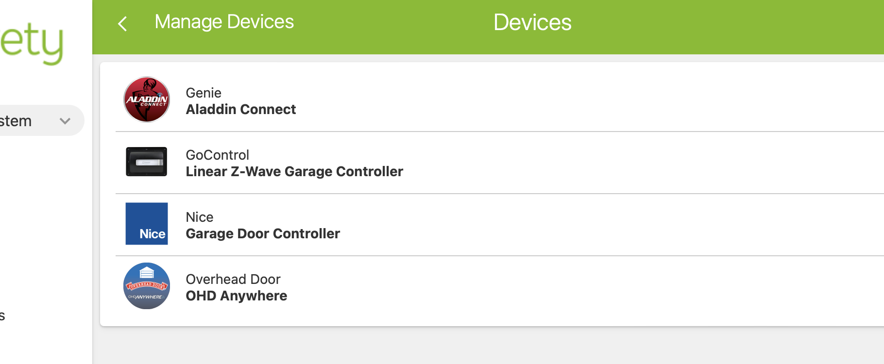

Also, unrelated, but MyQ garage is not an option under garage. It’s only alladin and overhead door even though I enabled it through system manager.

Not sure about the first issue but MyQ devices can only be added through the website, not the app.
It’s weird, I know.
The above is correct, MyQ is an optional add-on feature. With it enabled in your system manager you can get started adding the garage doors in the Alarm.com website. The MyQ setup option does not show up in the app at this time.

There is not a MYQ option It’s only the 4 options attached.
MyQ is an optional add-on feature. It must be enabled in the system manager here first, then you can find the option in the Alarm.com website to add MyQ garage devices.
