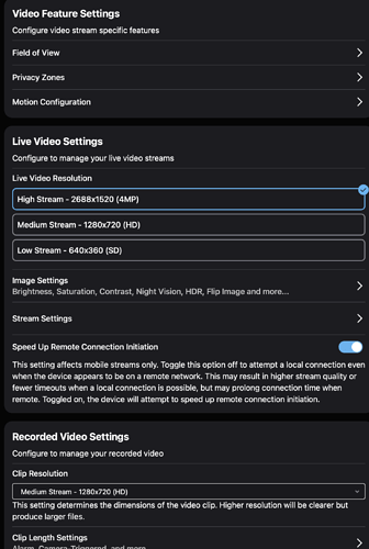

I wasn’t able to get any additional documents yet, but Alarm.com confirmed to me that the Prism cameras can record at 8MP resolution to the CSVR.

The ADC-VC8498PA is an 8MP varifocal dome. I don’t see how it would be similar in video quality to the older 2MP ADC-VC838PF with 4X the resolution and all the new camera improvements. I wonder if something might be off like the image resolution is set lower than it could be in the camera settings? Or maybe the focus needs to be adjusted?

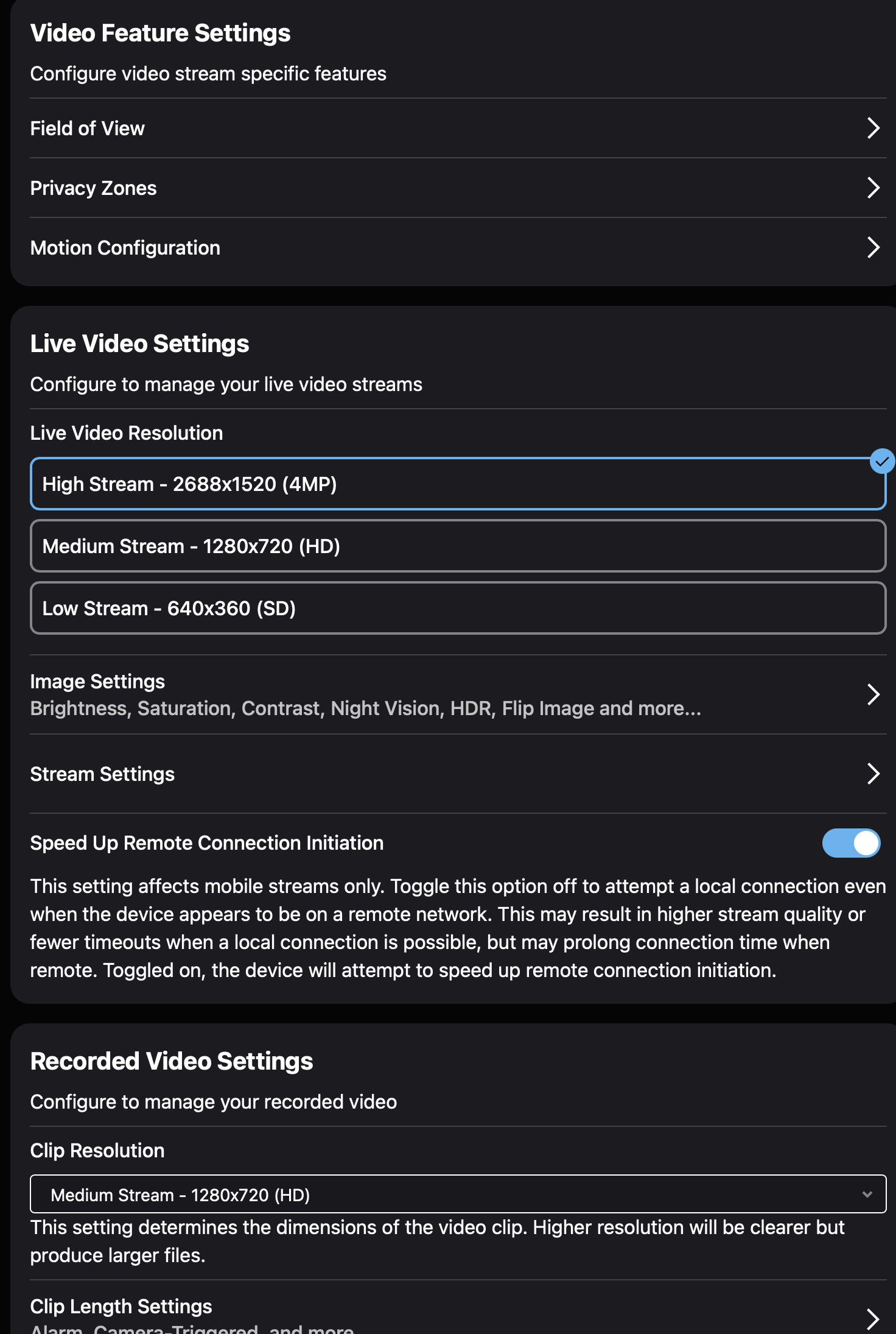

A few observations:
- While the camera claims to be 8mp I can’t see anyway to enable 8mp resolution. Unless it is only for the dVR recording. If you look at the video settings in the App this is what it shows:
- The other observation is the video quality is much better during the day. Day video quality is significantly better on the VC8498PA than the Ring Floodlight Cam Pro, but night quality seems better on the Ring which seems to pick up more light.
- The camera seems to be a bit of a Beta since it seems it won’t enable AI Deterrence. and also I just found out it is not able to do Vehicle recognition which my old camera VC838PF could do. I suspect both of these limitations are due to incomplete software on Alarm.com’s end. Surprised they released it missing some advertised features.
