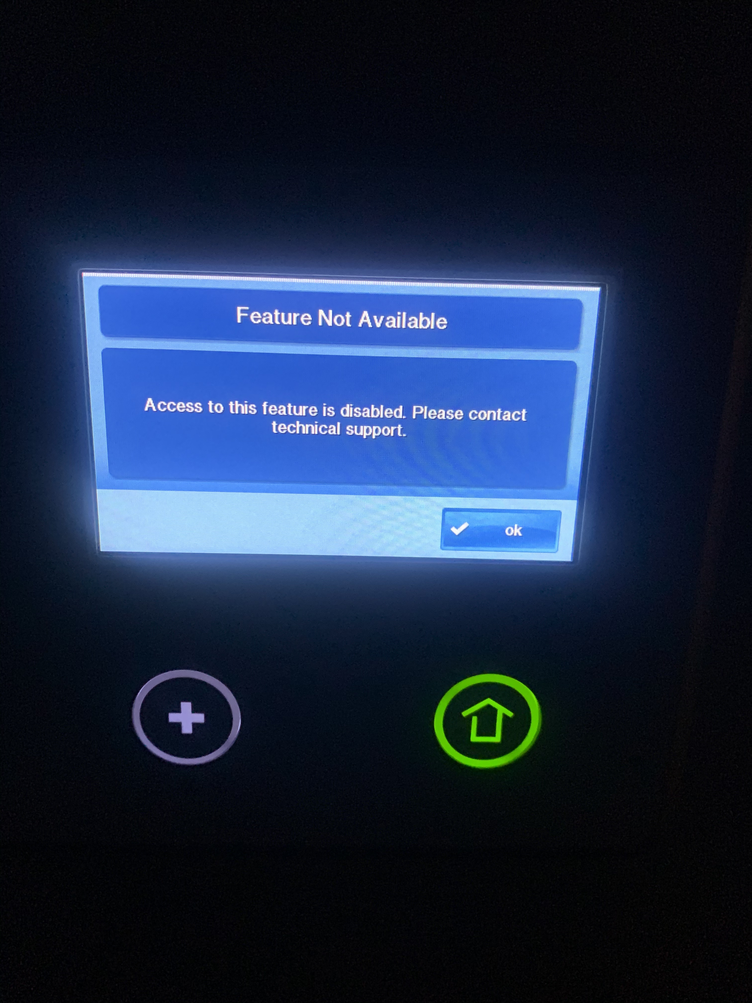

Performing a factory reset I think is actually possible with the panel in alarm state, and it will revert the code to 1111, but a couple issues there: The panel will lose all sensors as well if this is successful, and in your case if it was last used with Vivint it definitely will just not work.
Some installers, including Vivint, lock out the reset option in programming.
You could always reuse the alarm sensors with a new panel. If you have a 2GIG Go!Control panel (not a Sky Panel) then all of the sensors would be standard 2GIG ones like the DW10. These could be used with another 2GIG Panel, or with the 345Mhz version of the IQ Panel 2+ here.
I disconnected the audio parts and powered it back on with the battery still unhooked. During bootup, I was able to get some information on the panel before the “armed stay” mode kicked in and locked me out of settings. Looks like it is the Skypanel. And it looks like the comm/network module is wired into the panel and not replaceable. I looked at his pic and realized mine was slightly different on closer examination.
I did have a factory reset option for a short minute or so before the panel finished its boot and went to the armed stay state. But I didn’t do it because it did say it would wipe all sensor information. It looks like I would be better off just getting a replacement panel if the sensors will work with the new one. Did the Sky Panel use proprietary sensors of some type?
