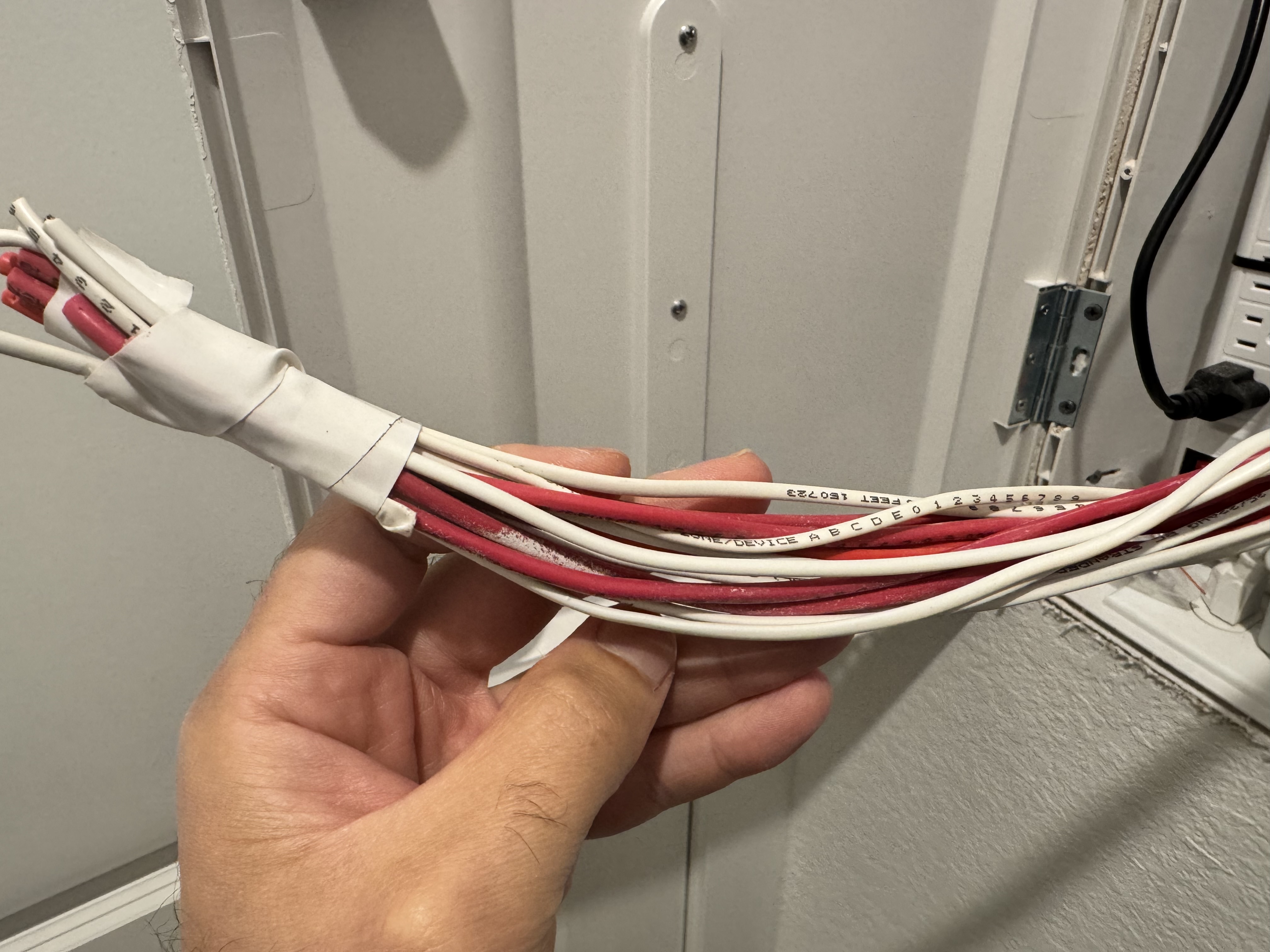

Yes, doors, windows, 3 keypad boxes, 3 glass breaking detector boxes are all pre-wired.
All the wires terminate at the utility room, but they have no tags about which one is which as it can be seen below!
Is there anything written on the wire sheathing at all? No numbers or names marked on there with a pen?
If the installers did not label any of the wires that will require testing and trial and error to identify what goes where. You would need to use a multimeter/ohmmeter to test continuity and identify which wires in the utility room correspond to which locations in the home.
For the doors and window sensors you can close all the sensors then one by one open them until you find the one that opens on the mulimeter reading. For the keypad and glass break wires you would need to twist them together/short them.
Once you identify one, label it, move on to the next. After all the wires are identified it will be easy to wire them up.
Testing a bundle of unlabeled wires can be daunting but will go quicker if you have someone that can help.
