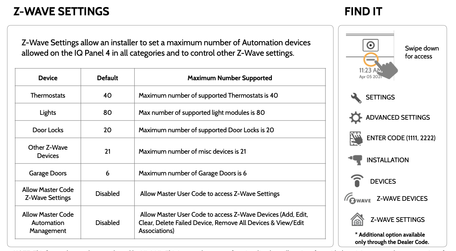

For the baseboard hot water heating, all zones are typical 24VDC control so I’ll need one of the regular thermostats. Can the panel support 8 T-3000s?

The IQ Panel 4 can handle up to 40 thermostats.
