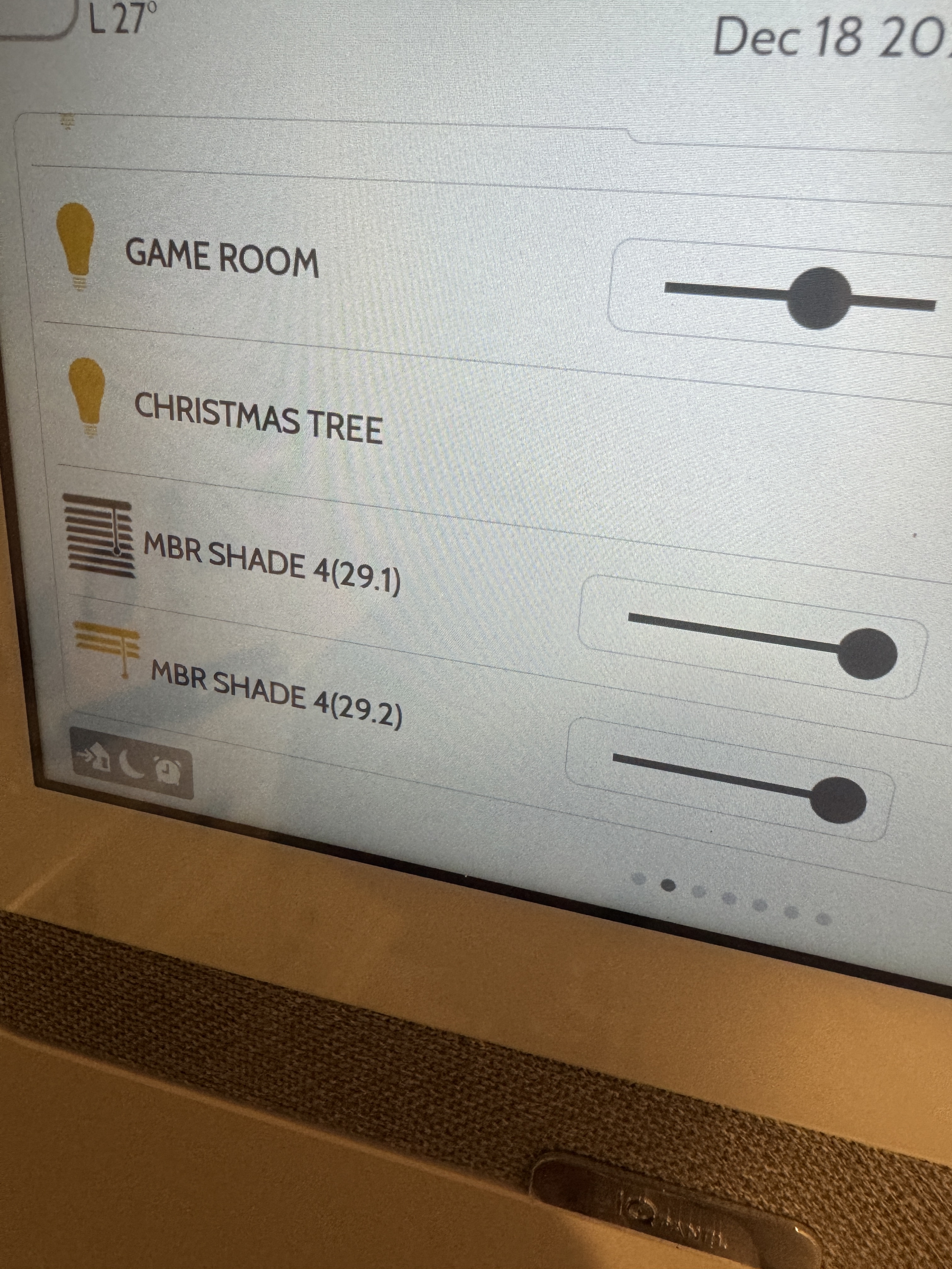

I have zwave blinds that show on my iq4 panel but not on the mobile app (I’ve waited a few hours and still nothing shows under devices). Any ideas?
Have you tried resending the z-wave device list to Alarm.com from System Manager?
I’ve never done that so will have to figure out how.
I see that device on your account, it will be on its own card on the Alarm.com home page as a shade. Do you see that shade now when you login to Alarm.com?
It’s there now on my mobile (on it’s own tile)! Swear it wasn’t last night, but thanks for confirming.
