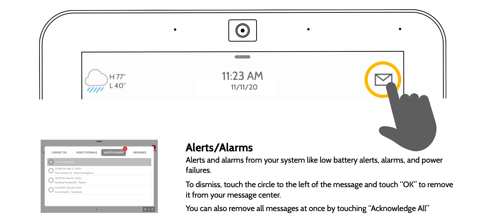

I think it would eventually go away on its own. Have you tried dismissing the alert?
Yeah I did. It’s still showing in alarm.com app as a notification though
