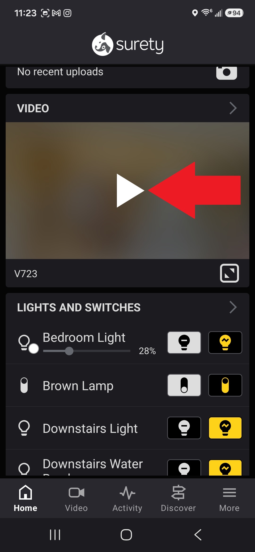

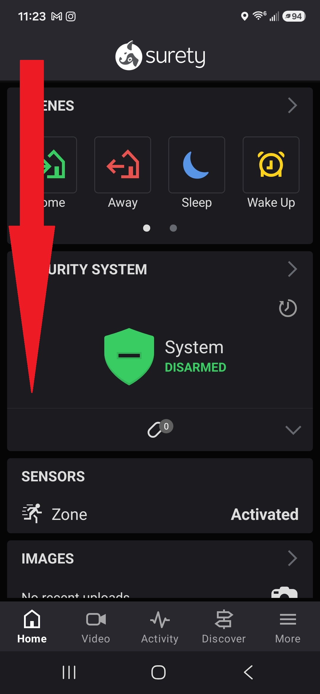

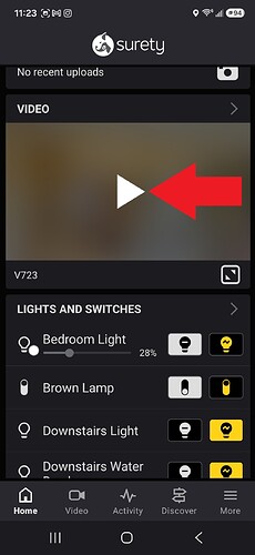

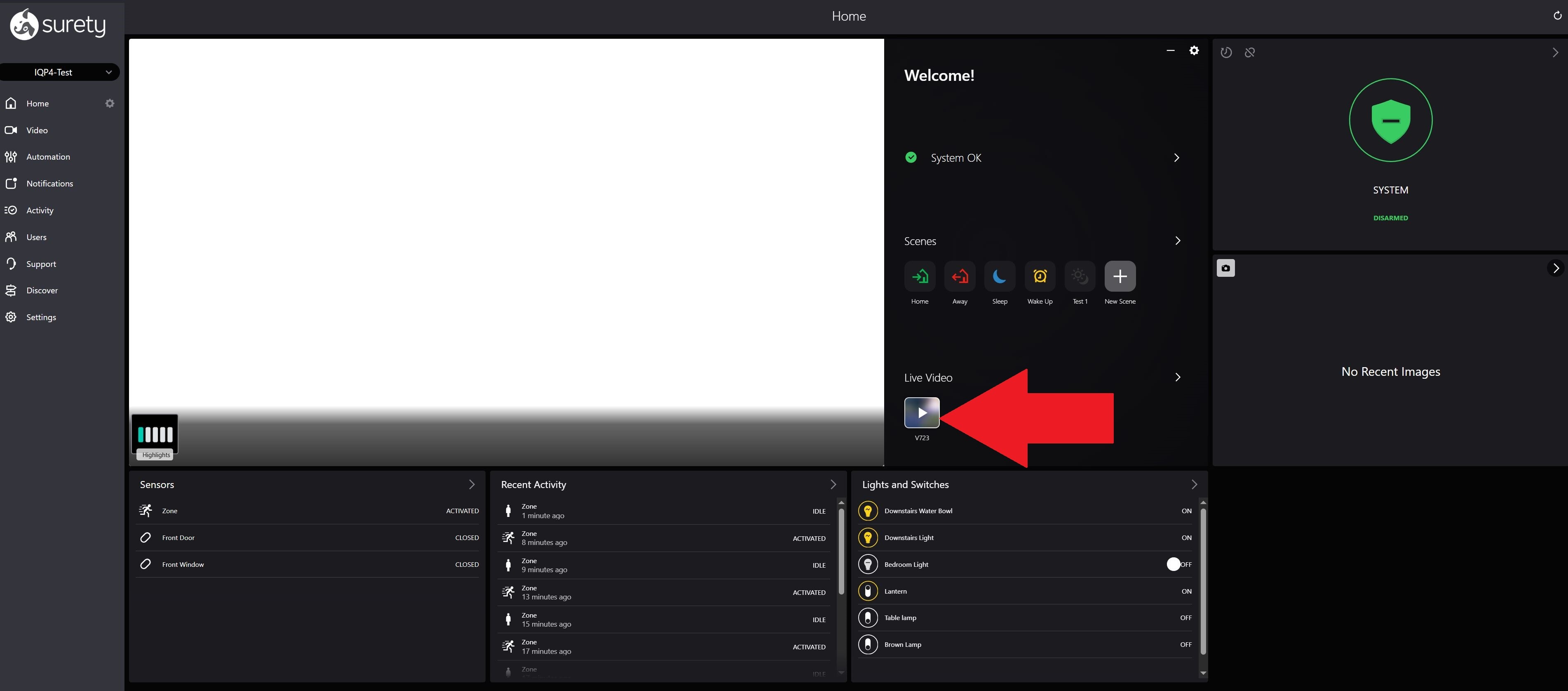

Access Live View from Alarm.com Mobile App
  • Scroll Down to find the Video Card
  • Click the Play Button on the video card to stream

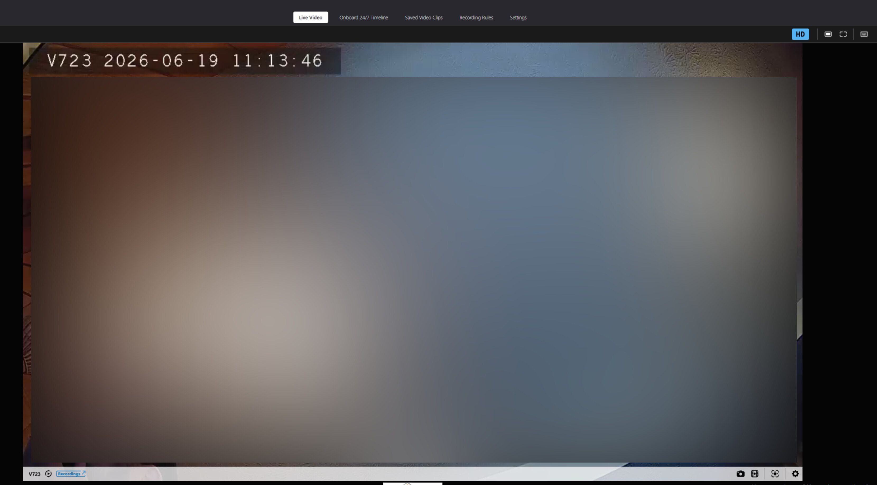

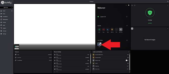

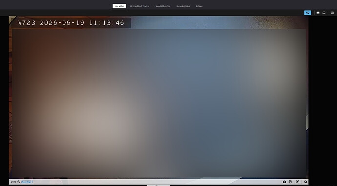

Access Live View from Alarm.com Website
Live video stream time out
Through the mobile app, live view times out within 3 minutes after the live stream starts. However, continuous live-streaming video is available through the Alarm.com Website and these devices/platforms:

Continuously stream live video using the Customer Website
To continuously stream live video using the Alarm.com Website, you will need one of the following video devices with firmware 0.6.7.852+:
  • 1080p Indoor Wi-Fi Camera (ADC-V523/523X)
  • 1080p Outdoor Wi-Fi Camera (ADC-V723/723X)
  • 1080p Outdoor Wi-Fi Camera with Two-Way Audio (ADC-V724/724X)
  • Pro Series 1080p Mini-Bullet Camera (ADC-VC727P)
  • Pro Series 1080p Dome PoE Camera (ADC-VC827P)
  • Pro Series 4MP Bullet PoE Camera with Varifocal Lens (ADC-VC728PF)
  • Pro Series 4MP Varifocal Turret Camera (ADC-VC838PF)
  • Pro Series 1080p Dome PoE Camera with Varifocal Lens (ADC-VC847PF)
If the video device is unable to maintain a continuous connection, it will revert to the standard web view with a 3-minute timeout. To confirm the continuous live stream is active, verify Combined-Shape.svg displays when mousing over the live view.

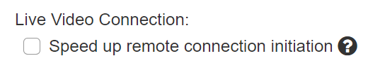

Speed Up Remote Connection Initiation
When Speed Up Remote Connection Initiation is enabled, the video loads faster while you are far away from the camera’s location. This feature needs to be disabled to continuously stream from the Alarm.com for TV apps.
To disable speed up remote connection initiation:
  1. Log into the Customer Website.
  2. Click Video.
  3. Click Settings.
  4. Using the Video Device dropdown menu, select the desired video device.
  5. Click Live Video.
  6. Click Speed up remote connection initiation to disable the feature.
  7. Click Save.

  7. In Live Video Connection, click to select Speed up remote connection initiation if desired. Leave this option unchecked to attempt a local connection even when the camera appears to be on a remote network.
