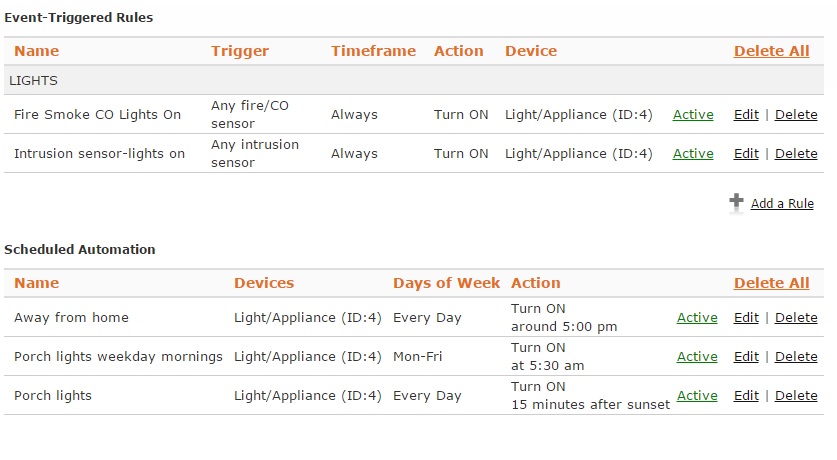

My lights are not reacting according to my settings on ADC. Is it possible someone can look at my settings and history to see what I am doing wrong?
To clarify:
Are you referring to triggered rules, schedules, or both?
How are they failing? Are they not turning on at all? Are they turning on in some cases and others not? Is a specific rule failing differently than another?
Typically the best first step to take in a situation where an automation rule does not act as expected is to recreate that rule in Alarm.com. This will force the rule to be re-saved at the panel to be run locally. Have you tried this with no effect?
I have attached a screen shot of my setup for the porch lights. Looking at alarm.com, I guess we currently have both triggered and scheduled. the triggered seemed to work although I only tested them once. I think it is the scheduled, or the bottom section that doesn’t seem to work.
They are intermittent. Sometimes they work, like the night time rule was working great for a while. the morning one has never really worked.
We have tried modifying the rule, and I think even deleting them and starting over. Today I removed the lights and added them again which resulted in the node being changed from 3 to 4.
Considering there are minimal devices connected, how far is the Z-wave switch device from the alarm panel? What kind of construction is between them?
Z-wave networks strengthen the more AC powered devices are present (battery operated ones do not repeat signals) so if there is only one or two, distance or interference issues can be amplified.
Can I setup up scheduling/rules locally?
Scenes can be set up locally on a GC3 but Automation programming for rules would be through Alarm.com.
That is strange as the morning one looks to be a simple time-activated schedule. If all are intermittent, I would lean toward a Z-wave network communication concern, but you could test by creating an easy rule to trigger, something like “when front door opens, turn on light for one minute, then turn off”
Test that rule every few minutes for a little bit and make sure it is working 100% of the time. If so, your other rules may not be saving properly. We can have ADC rebuild the rules to see if there is a positive effect.
The Switch is literally about 1 foot from the panel. The switch is just outside the interior garage door and the panel is just inside the interior garage door. I will try a couple of the things you mentioned and get back to you.
Well then it is unlikely to be distance related
Still not a bad idea to test the sensor trigger rule. It is a good way to create a reliable trigger and make sure the switch and panel are communicating 100% and verify issues with the schedule processing.
However, at 1 foot it rules out a chunk of possibilities. Interference from other devices is still possible, but I’ll have ADC push rebuilt rules first and see if you notice better performance.
