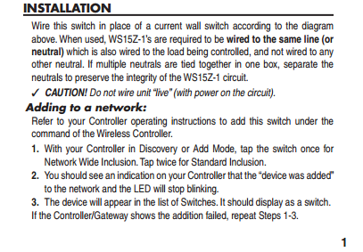

I’ll give it a try but the only way I learned the switches to the panel wad by hitting add device on the panel. I didn’t have to do anything with the switches themselves
A Zwave device cannot be included in a network without requesting inclusion, then it is locked to that network until removed. I see you posted images showing node ids in the 2GIG panel, but you would have had to perform a learn procedure on the switches.
When you select “Add Device” at the 2GIG Panel, your panel will listen for a new device to be added. See from the WS15Z instructions attached below for network inclusion.
Those devices will all three need to be part of the same network in order for the associate to function.
Just for a clean slate it may not be bad to start fresh.
