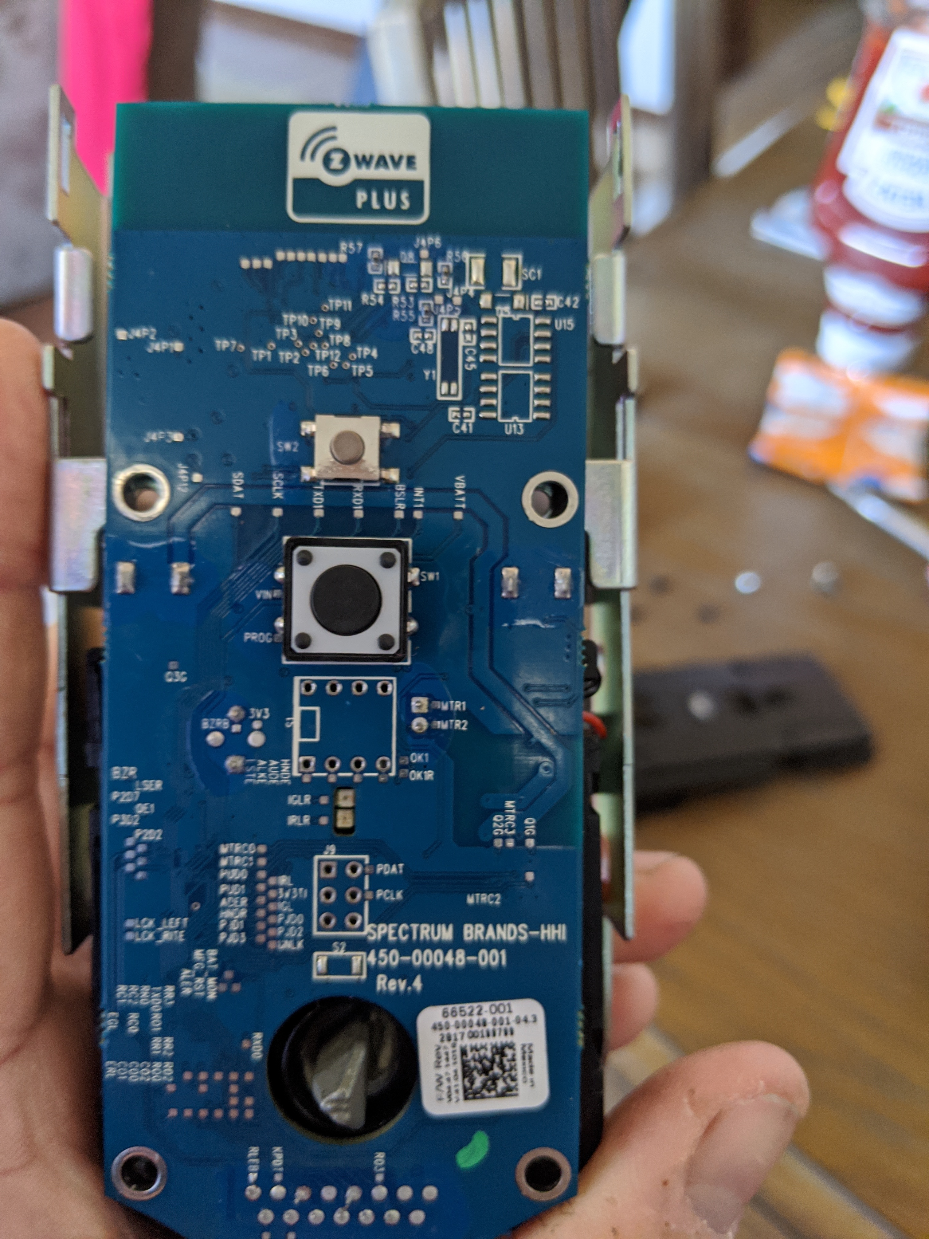

According to the ADC Ecosystem page, only the Z-wave Plus version of the Kwikset 888 is officially supported. Can you confirm whether the locks you have use legacy Z-wave or Z-wave Plus?
Not sure how to check that?
There would typically be a sticker/printed image on the product and/or packaging that looks like this:

As Nick & Jason mentioned above, only Z-Wave plus versions of the Kwikset 888 are compatible. Can you verify these locks are Z-Wave plus? If you still have the boxes they came in it should have the Z-Wave Plus logo, not just the Z-Wave logo.

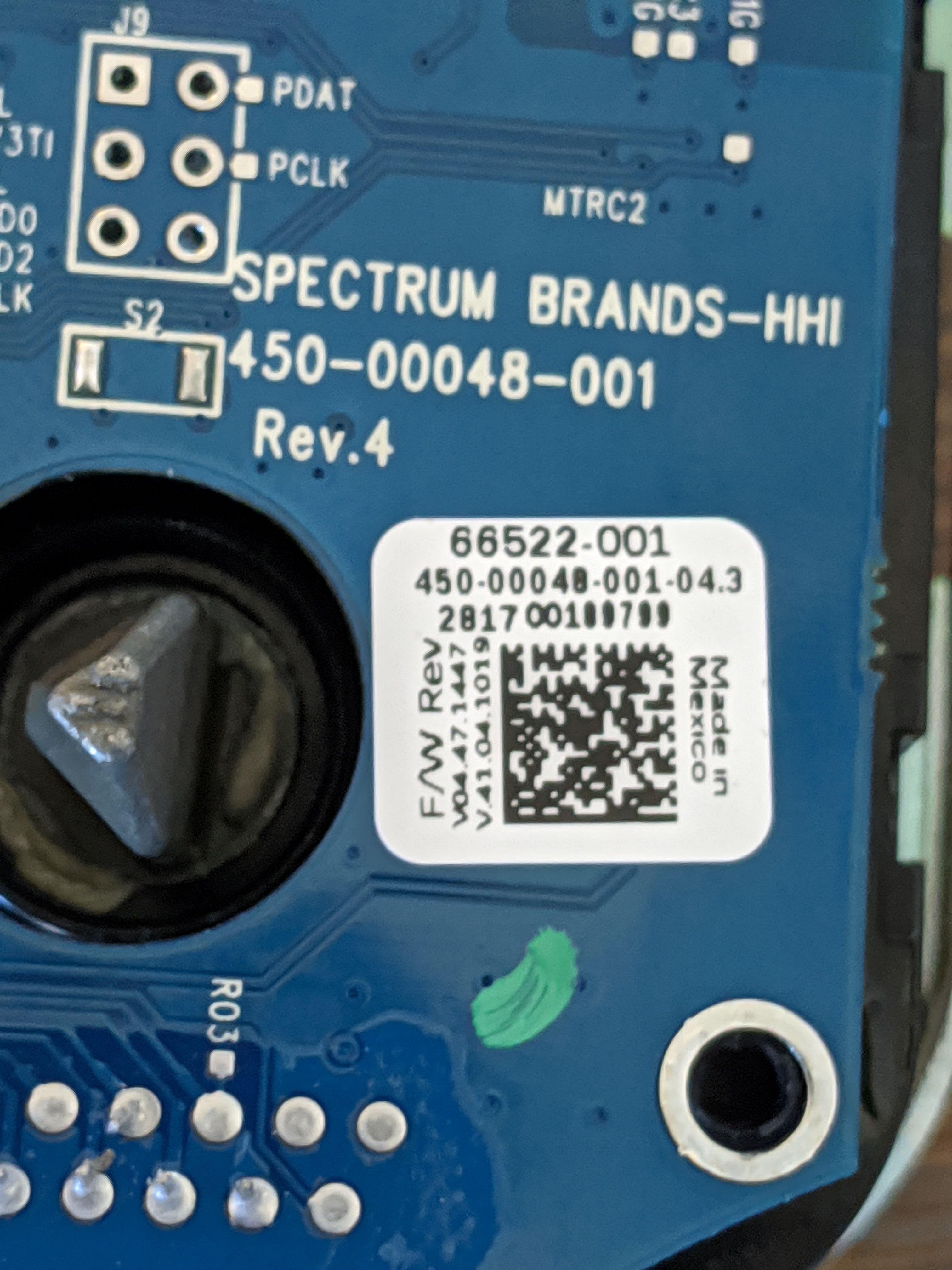

Another way to check is to look at revision number on the Z-Wave chip in the lock. When you’re facing the lock, pull out the battery slide so you can see the reset buttons. On the top there is a little black ledge you can remove. Pull that out and you should see the blue Z-Wave chip. On the chip there is a sticker with a revision number. What’s the revision number?
The revision number on the sticker is blurry in the pic. What revision is it? I think it’s compatible but since we’re running out of options I’d like to have any detail I can get.
Thanks. Anything above 3.33 should work so 4.47 should be fine.
