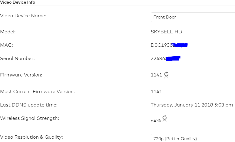

Just curious if you guys could please push the new firmware to my SkybellHD? I thought I saw FW1148 available in my ADC dashboard, tried applying the update, but then upon refresh it shows 1141 still, and no more “Update Firmware” link.
1148 was applied recently. It looks like it had completed, but it is a test version that must be sent by ADC. If you pressed Update firmware you would overwrite with 1141.
We will request ADC resend. Please do not use the update firmware button in video devices settings at this time.
