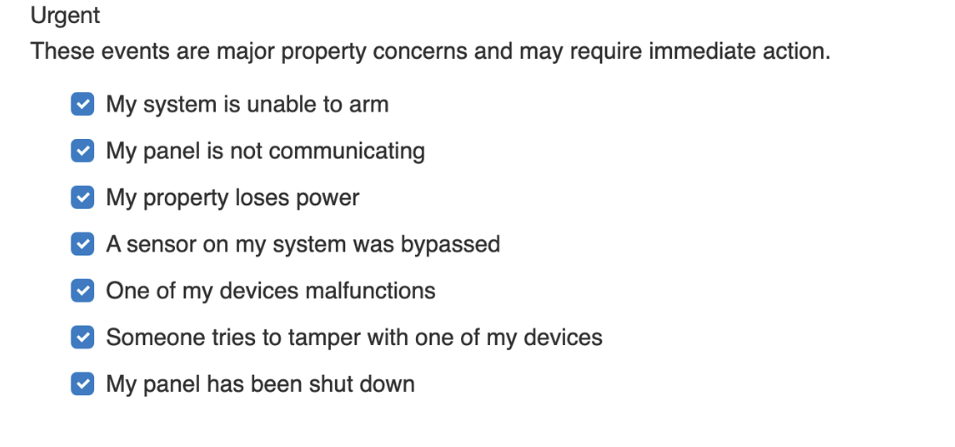

I think your information is incorrect., We had 2 tamper alarms while armed and no dispatch was sent.
Surety can verify my claim
These are the actions that notify but do not dispatch as posted by Surety on another post
This says they do.
I think tampers are a special trouble condition that is treated as an alarm when the system is armed. I could be wrong though.

Finally, tamper alarms and alerts don’t dispatch police. They just notify you on your phone.
This is only true while the system is disarmed.
When armed, tamper events are treated as an alarm, whether on a sensor or the panel itself.
Standard dispatch rules apply, including disregard per abort, cancel/verify in ADC, etc.
