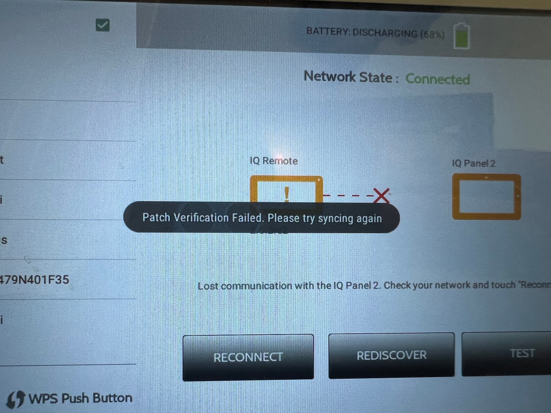

Hi, I’m trying to upgrade my two IQpanel remotes and they keep failing with the same message. I upgraded the IQpanel 2 to version 2.7.0 with patch tag. Then when the remote panels try to upgrade, they keep failing. I’ve tried rebooting, rediscover, reconnect, and test. The devices pair to the main panel and are receiving valid IPs on my LAN. They just keep failing after downloading patch to 100%.
What should I try next?

The panels are now connected to the IQ panel access point, but its the same result of patch verification failed. I connected the remotes by IP to main panel when doing a reconnect and it finds panel to start patch download again. Gets to 100% and then shows same error.

I’m having the same issue on my IQRemote panel in our bedroom. I’ve rebooted, reconnected, rediscovered, tested, master reset, rebooted both panels, verified connection on the same network (they see each other and talk to each other successfully).
It breaks at the point when it’s downloading the update, then “patch verification failed”. I can’t get out of the main wifi/configuration screen. It’s non-functional.

The current firmware on the remote shows as 2.5.4rc19. I just upgraded the panel to 2.7.0rc to see if it would fix it, but it did not. Same behavior, downloads the patch immediately after establishing connection with the main panel, then the message patch verification failed.
